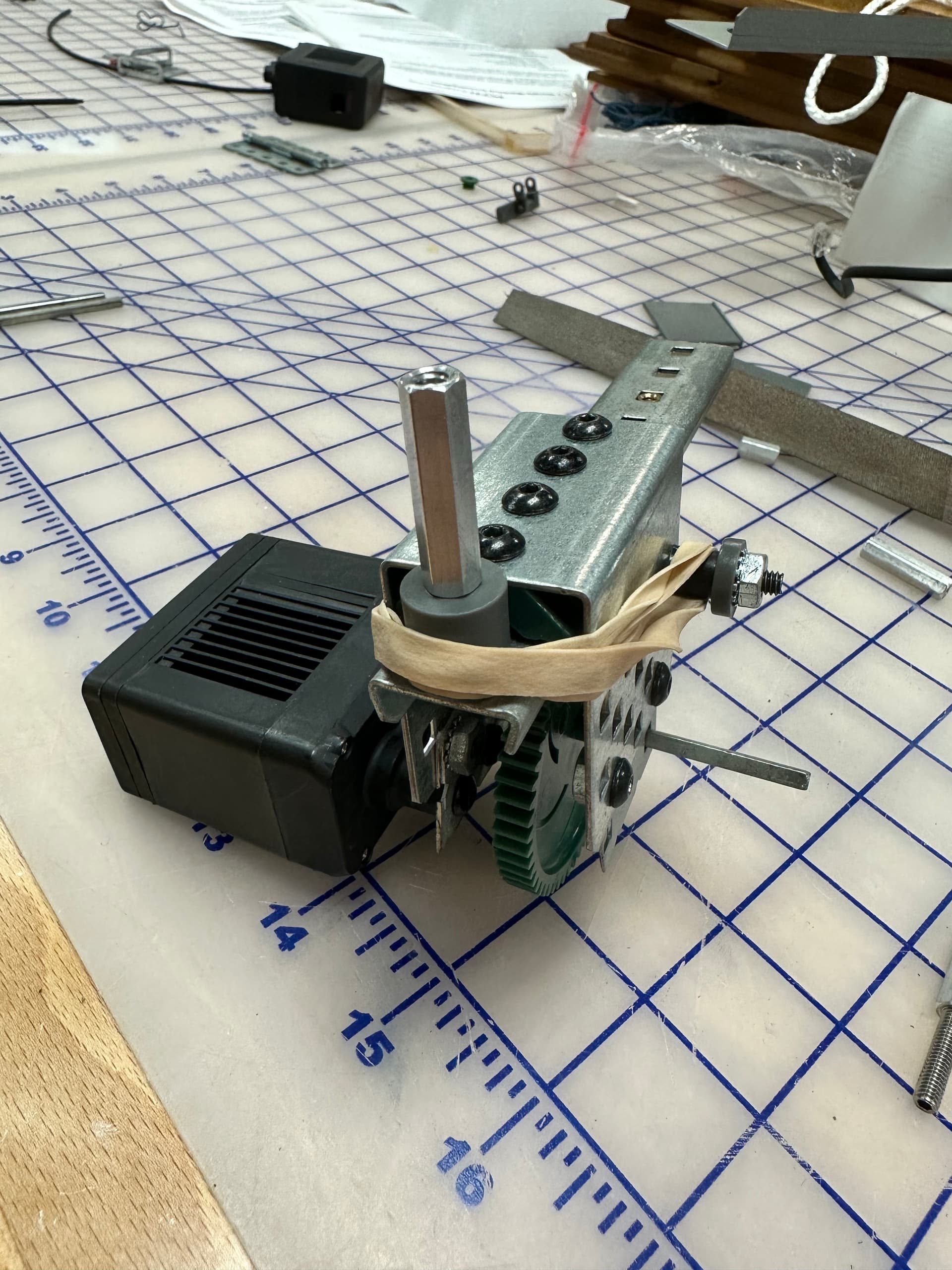

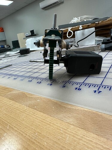

I was wondering if I could get help with the piston and how it works and how to built it? Also how the limit switch plays into the system? This is what we have so far.
Sure! For starters that is none as a linear slide, not a piston. That should work perfectly as a motor indexer, but make sure you have sanded the gear to make it a slip gear. (I can’t tell if you have from the photos sorry). For the limit switch, have something on the moving part of your slide activate the switch right before it is about to slip. Then tell the motor to spin until the switch is pressed.
