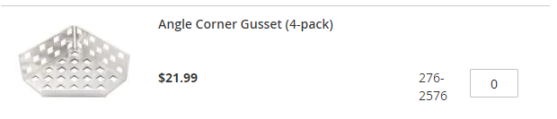

scroll to the bottom… part 276-2576 - Angle Corner Gusset.
Cad is included on the “CAD Files” tab
does anyone know what piece this is and tell me the peice’s name and number
Are you asking about the piece that was highlighted in you previous pic? If so, then I linked to it in my post above.
Angle Corner Gusset

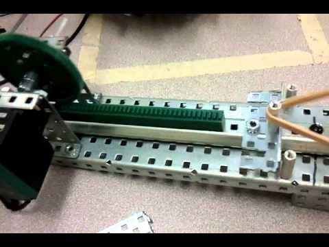

I’m a bit confused by your indexer design, could you explain it more for me? I don’t have a computer that can handle any CAD software atm.
It looks like a linear puncher. Linear punchers use a slip gear to release the force of rubber bands that are pulling the slide forward. The gear then turns to move the slide back, stretching the rubber bands, then when the gear gets to the part with no teeth, it slips and with the force of the rubber bands launches forward.
This is a design from a game in years past but its the same concept
Heres a more recent prototype of a linear puncher from this year’s game
If I am not mistaken, there is a distinction between linear puncher and slipgear indexer— the intent of a linear puncher is to launch the disc using the tension in the rubber bands, the intent of a slipgear indexer is to push the discs into a flywheel.
Yes your correct. Although when using a linear puncher as an indexer it should have less rubber bands than when using it as a launcher, having the disc enter the flywheel with more initial velocity will reduce the rpm drop of the flywheel, increasing the rate of fire
