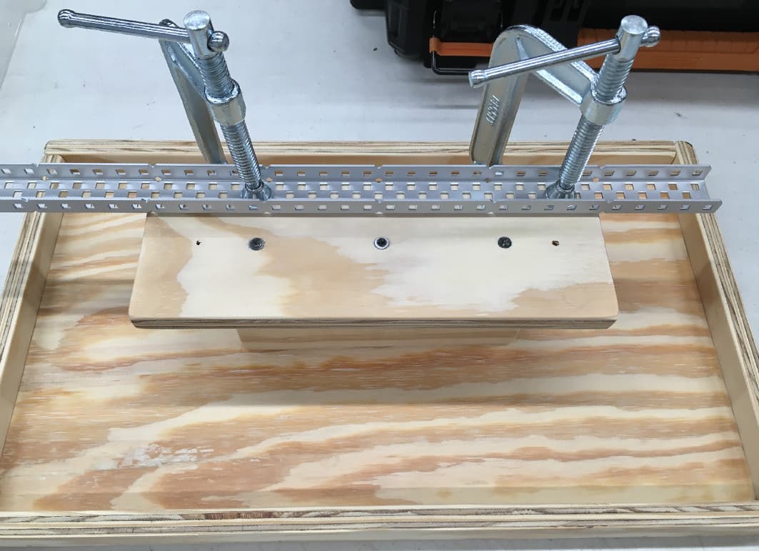

I made a tray w/ protruding center table for cutting metal. Plywood tray/base approx 12"x16" with 1" side. Center pedestal approx 4" tall with 4x8 plywood on top. Design allows c-clamps to hold metal easily. “drops” or cut pieces fall into tray.

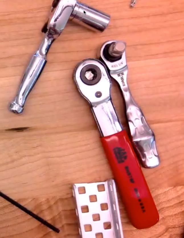

You say you have the usual hand tools, but I’ll mention these for general interest: ratchet drivers for sockets and hex bits. These are some I like.
• Tekton 1/4" drive ratchet (SRH11003) and 11/32" socket(SHD02009).
• Wera Zyklon Mini 1 (8001A), a driver for 1/4" hex bits. It also comes with an adapter for driving 1/4" sockets.
• The red-handled item in the photo is another hex bit driver, from MAC, which doesn’t seem to be available at present. (BWS7BF)
• and of course 1/4" hex bits (for hex or star drive) in the relevant sizes and lengths
