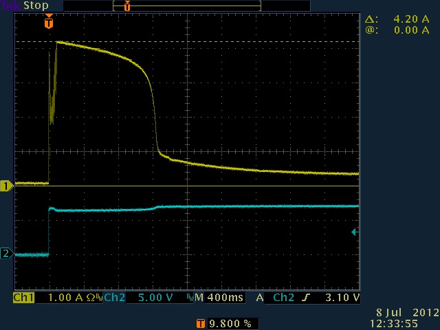

One final test, stall the motor at maximum power, measure the current.
This was actually a different motor so slightly different result, approximately the same current, PTC trips in 1.2 seconds which is when the current drops from the 4.2A maximum to about 1A and then slowly to 400mA. Slightly strange behavior here but that’s to be looked at on another day.
So the first conclusion based on these measurements is that indeed the old 3.6A spec was a little optimistic and 4.8A a more realistic number.

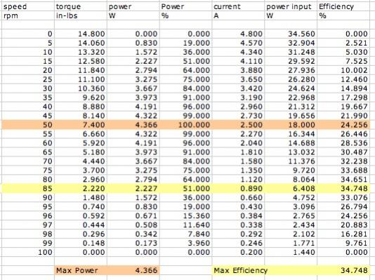

And here are my revised theoretical graphs based in the new IFI specs with the adjusted no load current. I’m leaving the no load rpm as 100 rpm even though we measure slightly higher than that.

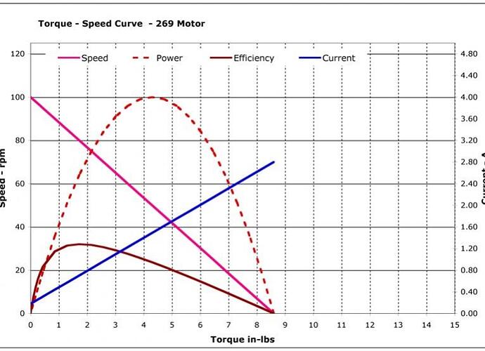

And for reference, the data for the 269 motor. This is also slightly revised and uses 2.8A as the stall current rather than the previous 2.6A. This was also part of the IFI posted data and confirmed by measurement.

I just want to make sure I understand this correctly… Lets say I have a 393 motor, and I take an encoder and find that it’s running at 60 RPM, is it fair to say that the motor is therefor using 2.40 amps and running with 6in-lbs of torque?
What happens if I were to run it at half speed (input of 64), would everything divide in half? Or could you say the RPM is at 30 then, and then whatever the values at 30 are you would use?
From the table below, if you are commanding the motor to run at full power, and if the rpm has dropped to 60 then the current would be (theoretically) 2.04A and the torque 5.92 in-lbs. So the answer is yes (except you had a typo on the current).
This is where it gets a little more complicated. A control value of 64 will not give you half speed, see post #7 of this thread. The graphs shown were for an unloaded motor and will change for a loaded motor.

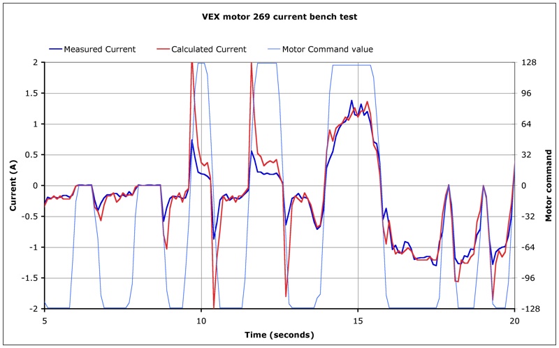

Also see this thread where I used the information from both sets of data (the torque-speed curves and the control value to speed graph) to estimate current (and therefore torque).
