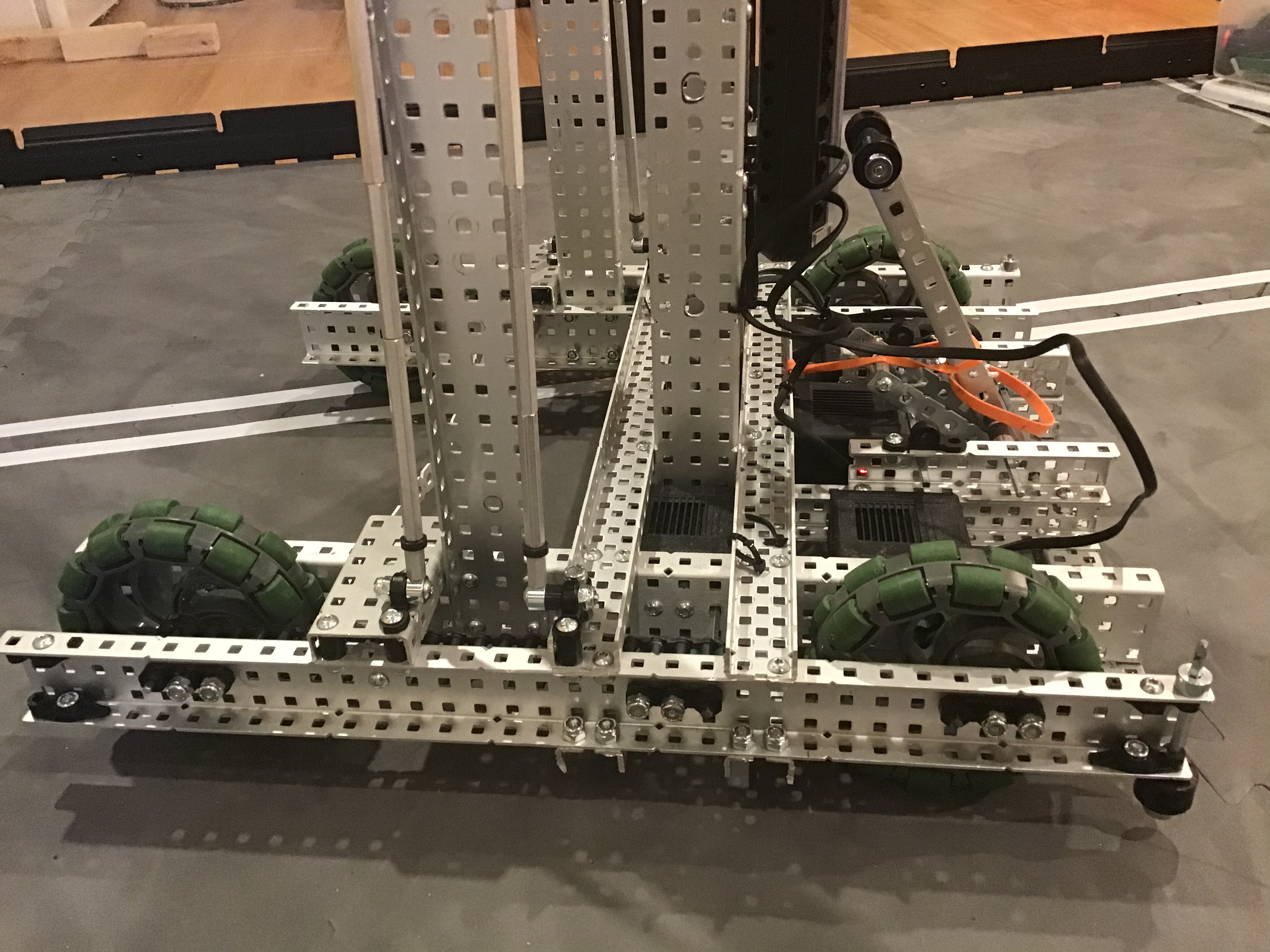

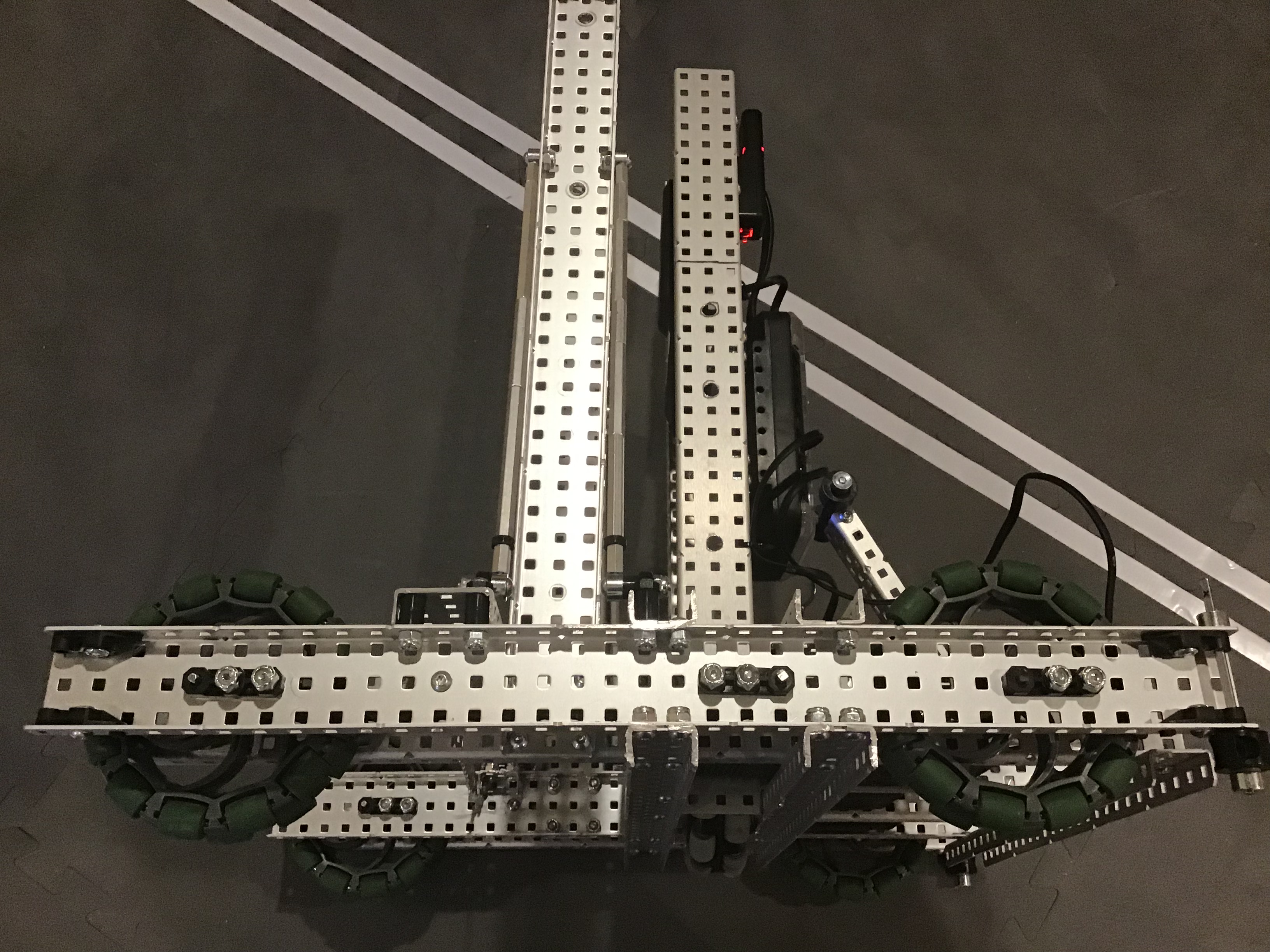

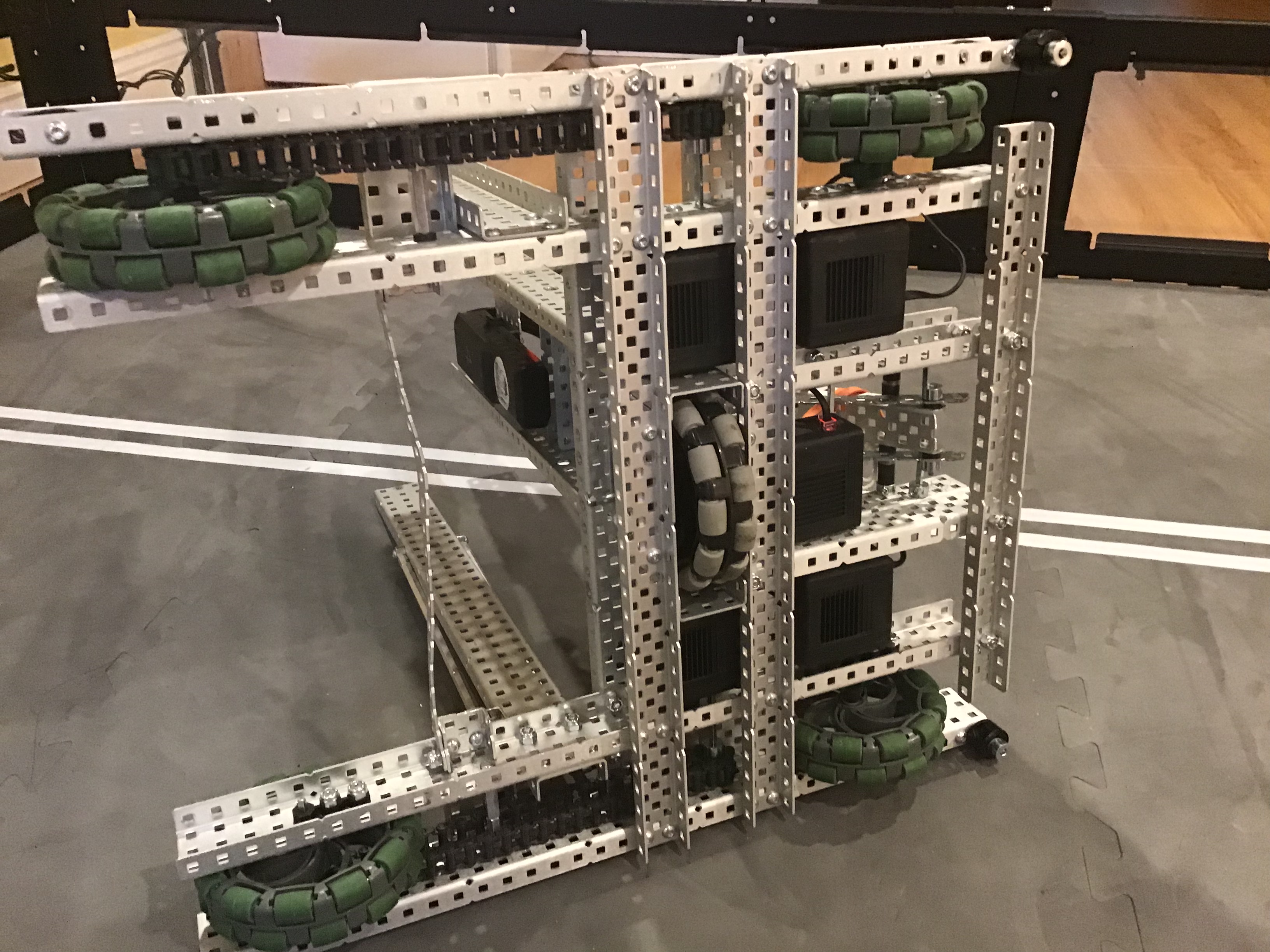

Hello, my Hdrive is inconsistent, due to the fact my mat and floor is kind of bumpy. So sometimes the horizontal wheel is to high so it won’t work, or it is two low making some of the wheels not touch the mat and therefore can’t drive properly. Do you guys have any solutions to this problem?
is there any spot in your area that is flat and smooth like a field? that will help it since like you said, the floor is the problem.
and pictures would help if it IS the drive base
that looks pretty solid, is your strafing wheel at the right height though? I’ve heard you want that wheel to be slightly lower than the others so it’s always firmly on the tiles.
Oooo. That looks pretty nice. When we tried to build an H-Drive it was so heavy that it would take us forever to move 2 inches. What seems to be the problem? Moving fast and then slow? It is driving or autonomous? What kind of tiles are you using?
Won’t that lift the other wheels in the air?
you only make it stick out a tiny bit more, so it can sink a little bit into the tiles.
Generally on uneven ground that’s just gonna be an issue with H drives. I would reccomend not using an H drive.
@Got_a_Screw_Loose had an H drive last season, he might be able to provide some insight.
Well since you’re going to call me out…
I had mine mounted differently so I could use washers to space the whole mounting assembly downwards into the ground as needed. It was slightly lower than the other wheels, but only by enough to give compression into the tiles. Because it was used for adjusting as opposed to movement, I drove it 1:1 off of a 100rpm motor. I never had any problems, and my bot weighed well more than 25lbs. (It was a conscious choice.)
