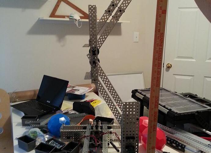

New and Improved Lift Design!!!
Presenting the all new DANNY LIFT
It is a new and improved lift design, that avoids all of the problems of Scissor, 6 bar, and Elevator Lifts.
https://www.youtube.com/watch?v=B-yuOukh-Hk
More information will be provided if there is interest!
[EDIT]
I am not trying to bash on any design, just introducing a new one.
Look below in my posts for explanations on differences from other lifts.
So you CADded a commonly known and sometimes used double four bar lift and named it after yourself?
I want to order mine! LOL:p
No, this is far different than a four bar. for example it starts with all bars horizantal, ends with all four vertical, and has a 5.8 to 1 extended height to compressed height ratio. Watch the youtube more, look more. I will also post more detailed pics in future.
And, by the way, my name is not Danny, he is on a different team at my school.
So basically, it’s a double four bar.

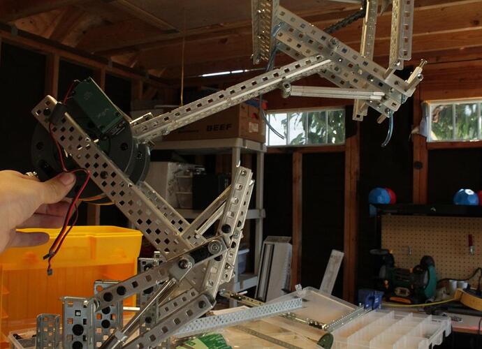

since we are talking about strange lifts, here is something I have always wanted to use in competition:
http://www.deere.com/wps/dcom/en_US/products/equipment/skid_steers/318e/318e.page?

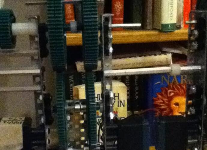

Here’s a prototype of it: (the lower stage)
https://vexforum.com/attachment.php?attachmentid=8346&stc=1&d=1398797118
The place where I am holding it goes up and down vertically.

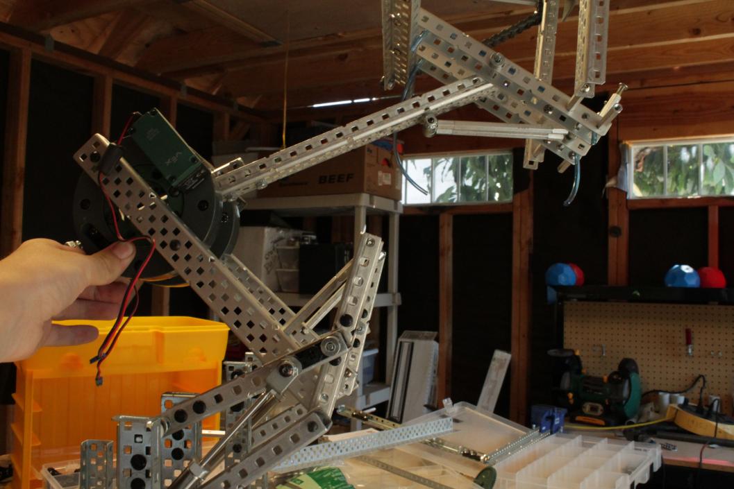

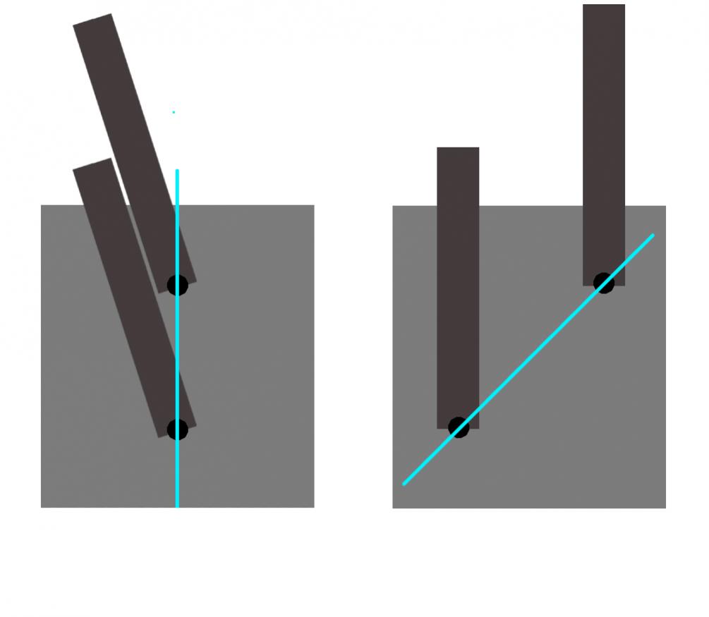

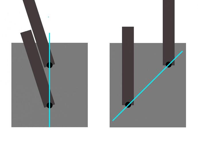

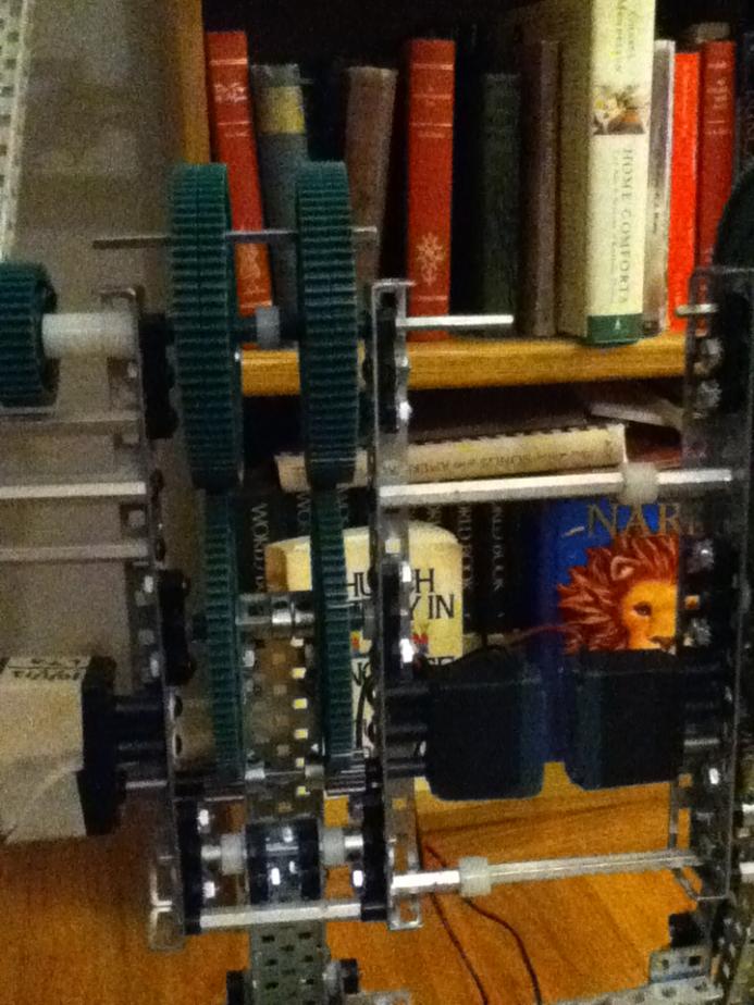

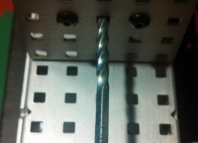

No, this is not really a 4 bar, see these views.
First, the bars are mounted in different places
Left = 4 bar/double four bar
right = Danny Lift
https://vexforum.com/attachment.php?attachmentid=8344&stc=1&d=1398796255
Second, the danny lift is driven from the center, not the rear, reducing friction dramatically
https://vexforum.com/attachment.php?attachmentid=8345&stc=1&d=1398796501
You can also see here that the two sections must be mechanically linked.

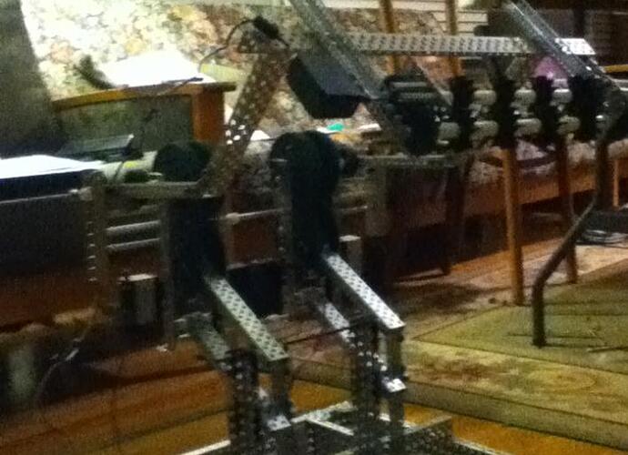

If you try to drive it from the rear, this will happen
https://vexforum.com/attachment.php?attachmentid=8347&stc=1&d=1398797260
every 4 bar variant is driven from the rear, but not the Danny lift.

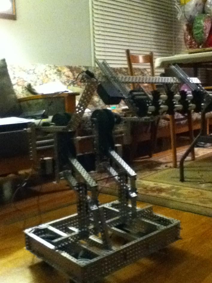

And for what it’s worth, here is a reverse bar powered from the middle:
https://vexforum.com/attachment.php?attachmentid=8349&stc=1&d=1398798362
here’s the gearing:
https://vexforum.com/attachment.php?attachmentid=8350&stc=1&d=1398798362
The problem with a ‘Danny Bar’ is that it can’t go below itself which cuts the height potential in half. I like to think of them as ‘half scissors’. they definitely have their applications though.
