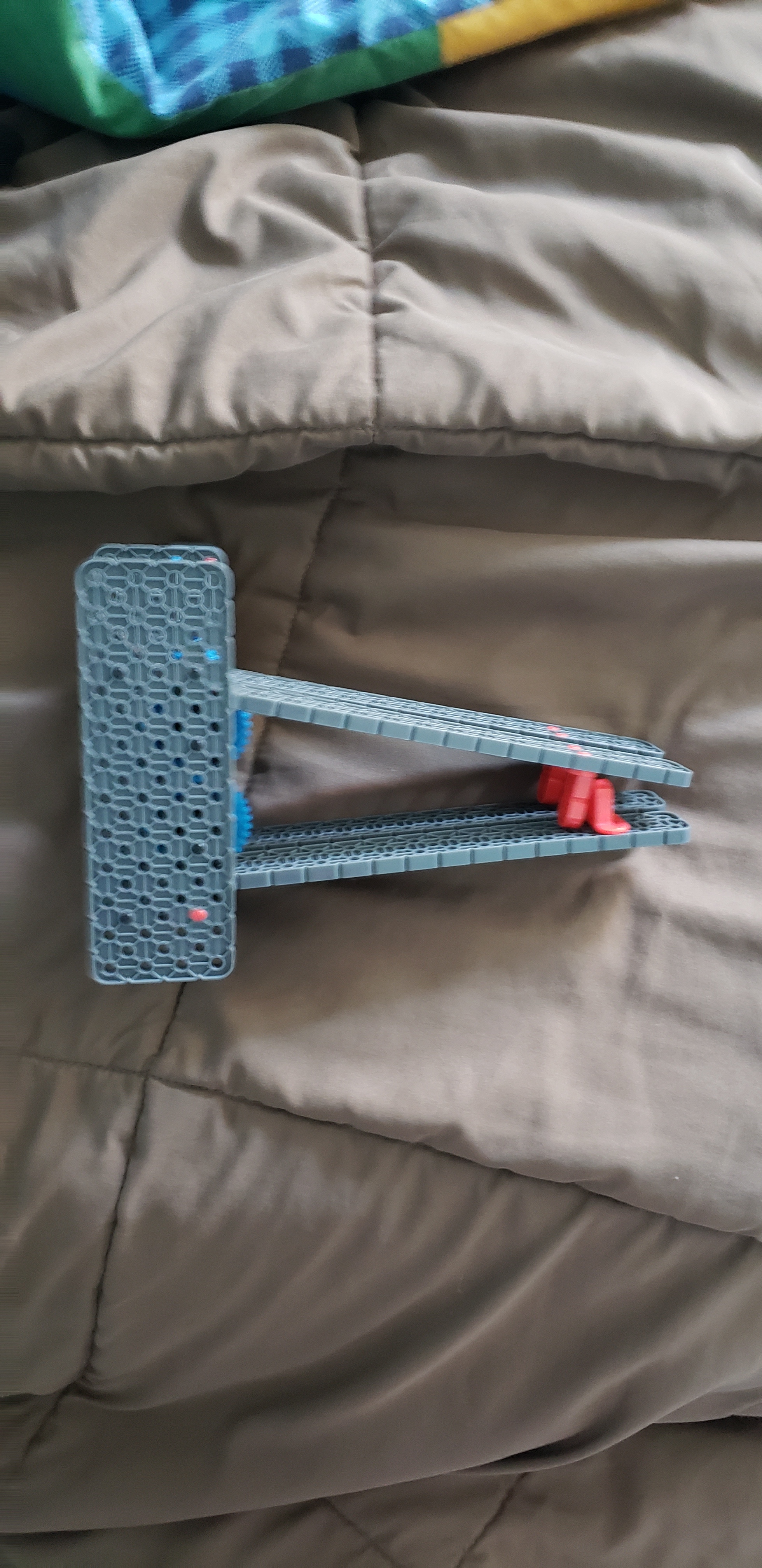

New claw for rise above
I created a claw, I tested it and it is cool. It needs some upgrades but it is good for stacking risers.

It looks nice, but I might recommend moving the 1-wide angle pieces out to the other sides, so that the claw goes into the insides and goes outwards to grab it, so that it doesn’t really matter which way you grab it from.

Why not put the angles on both the insides and the outsides?
I guess that would work too. Then you could grab a riser from the inside or the outsides… I like that Idea.
It is an interesting idea. The problem with that is that there are too many options. For example, in the last seconds of a match, you could be contemplating whether to grab from the inside or the outside, and that could result in you not getting the stack in time. I know because I tried this, and what I mentioned above happened many times.
For lower level teams though it could be a good option as time in a match is less valuable. I am not putting down anyone or anything, just explaining why I didn’t do that idea.
I was thinking it might make it easier with regard to riser orientation. If the vertical standoff between the riser layers is facing the robot, grabbing around it would work better; if the robot is lined up with the gap between the standoffs, then an inner grab would be the choice. With enough practice, the drivers would kind of innately expect which way to go.
Especially during the programming skills runs, this adaptation could slice some valuable seconds and lines of code spent positioning and orienting the robot.

Alright, I see where you’re going with this, and I think it could work. My only concern is if the standoff is in the middle of the two positions. I think that like you said, driver practice can solve this problem. It definitely is a valid idea. Good luck with it!

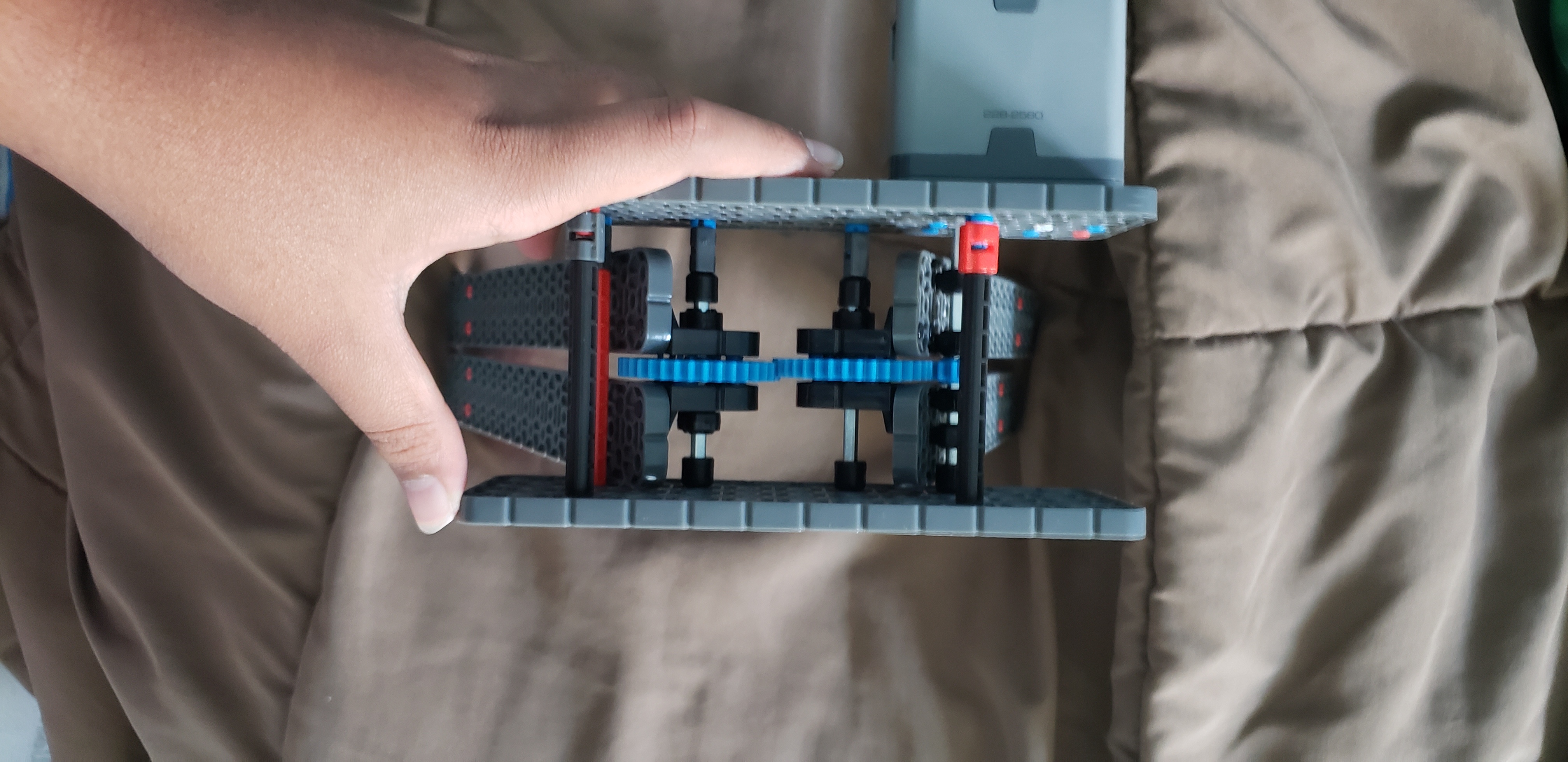

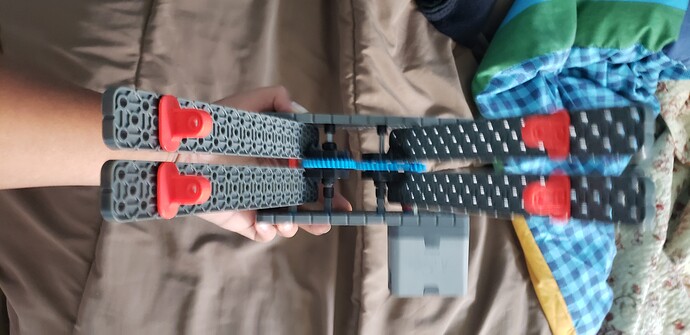

That’s a neat idea. How does that perform when moving 2 risers? Is there another layer of triangles to keep the top riser in place? Or does it still have a topjaw come down to capture and hold?
So, @Sharky_do is that claw kind of like the Razorbill claw?
Yes it is kinda like the Razorbill claw but it is used to grab risers from the middle.
