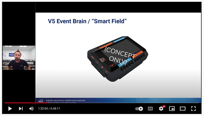

Is this the final GUI layout for the field brain? It seems somewhat strange to me to have robots on the same alliance be plugged into opposite corners of the brain rather than the same end or same side.

Yes, for now, because of this.
(from Event Partner Summit 2020 Day One)
If the “concept” changes, so will the UI.

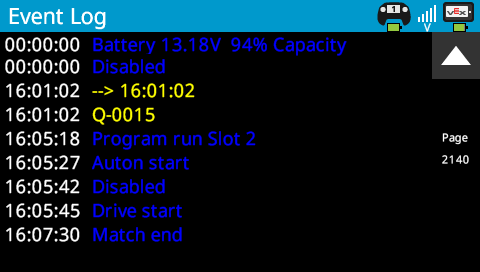

Most information, including a match clock, was already being sent back from the controller to the brain for the last couple of vexos versions, it was just generated locally inside the controller. The match clock is used to synchronize the timer display on controller and brain.
We do send a few new things from the FC that were not available before.
When using TM, we can synchronize the internal time for the FC (field controller) and robot with actual time. We use that so any log entries now have a real absolute time stamp rather than just relative from when the robot was turned on. We can also send event and match information to the robot brain, this is added to the log and can help with debugging, it will make it far easier to see if a robot had issues during a match, for example, did a motor become disconnected.
Here’s a screen shot from yesterday, clock was to to 4:01pm and qualification match 15 was run.
log_2
More information is being sent back to TM than is being sent to the robots. We can detect not only that the controller has received the match control information, but that it has also been sent over to the robot brain and received, there should be no more doubt about whether a robot was enabled by field control.
We verify the robot is running correct firmware, that the radio is set correctly and which program is running on the robot.

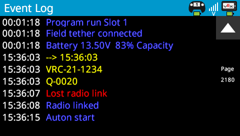

Out of curiosity, is there enough of the data being sent back and forth that will help identify white screen conditions? Or even enough data that would help identify conditions that could lead to fixes for some white screen conditions?
The only thing that field control will know is that the controller has lost radio connection with the brain, there’s no way to distinguish that from say a radio cable being removed from the brain.
I still believe that white screen is caused by an intermittent battery situation, an issue with either brain, battery or cable connectors being damaged, loose or not properly seated (based on my tests and anecdotal evidence, there may be other causes). It’s hard to actually distinguish this from a battery shutting down due to low voltage or a complete disconnection from the point of view of the FC.
We do have status of the robot battery capacity, but we have decided for the time being not to show low battery as an error on the TM field queue display, it’s difficult to set an exact threshold for where there’s not enough battery capacity to run the robot for the match.
Battery capacity and voltage is logged at the beginning of every match in the student robot, it’s been that way for a while.
