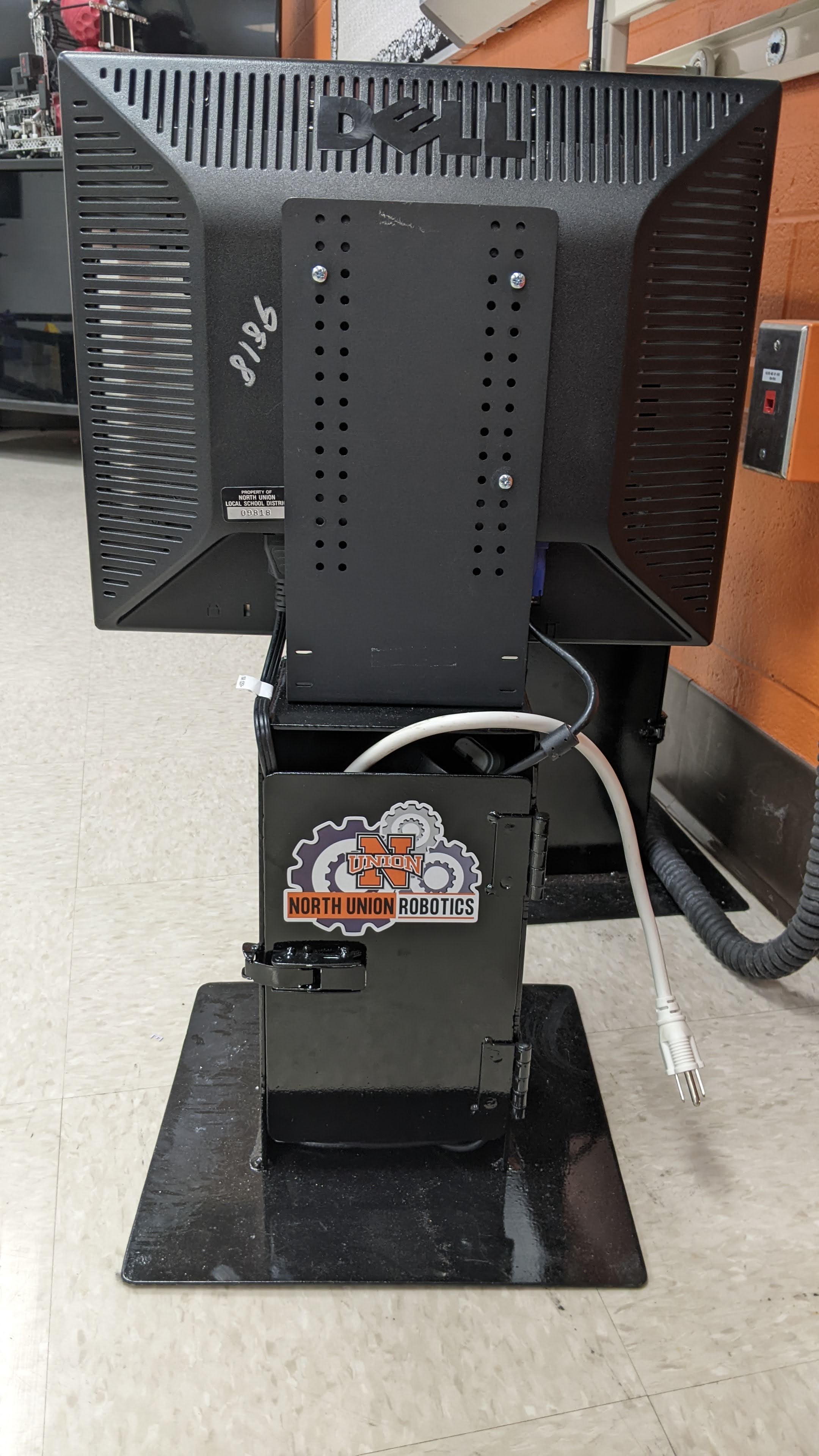

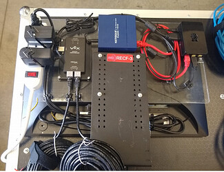

Great Idea! All of our field electronics are enclosed in a custom-made field timer enclosure.
Thankfully we don’t have the “Helpful” volunteer messing with the Technology aspect of the event. So we are pretty lucky in that respect. But I like the idea of the USB dongle. I’ll be interested in how the new field control system works at Worlds. As long as there are minor “bugs” like this, it should pan out ok. But, if there are major issues, we will probably stick with the legacy controller next season. We shall find out next month! But, I do like that they are always trying to improve the experience and the technology.
We have our stuff wide open for a “high-tech” look…with enough zip-ties to mostly keep helpers from unplugging stuff. If/when we update our Pi’s, I’ll get clear plastic cases for them, too.
