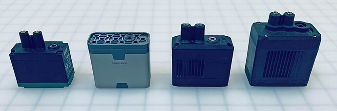

@jpearman I’ve noticed this on both kinds of V5 motor now, and I have to ask, what on earth is the point of those fake cooling vents? Why not put like… actual cooling vents there?
Also am I correct in saying that there are no cartridges for these? Are they similar in power and speed to a 393?

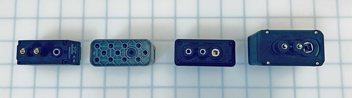

The new V5 Smart Motor (5.5 W) motor is essentially a 393 Motor + IQ Smart Motor:
The new V5 Smart Motor (5.5 W) contains the motor from the 393 Motor, the same gearing and integrated encoder from an IQ Smart Motor, a new full metal gearbox output carrier (with a fourth planet instead of the three inside the IQ Smart Motor), and a new temperature sensor that will be adhered directly onto the motor itself (which is how we can get more usable mechanical power out of this motor compared to the prior 393 Motor).
There are no swappable cartridges or gear ratios; the motor will always have a free speed of 200 RPM and fixed overall ratio of 64:1.
The “cooling vents” were mostly added to the V5 Smart Motor (5.5 W) because their bigger (11 W) sibling already had them, and thus it formed a consistent visual design language between the two motors. We do not want any actual openings in the motor housing, because then metal dust from cut / filed pieces of metal has an easy ingress route.
We also changed the aluminum mounting standoffs to steel.

Can I ask why they were there at all on the 11W ones? Did they have any point, or were they purely aesthetic?
Love the new motors. Hopefully they’re VRC legal and we can use 2 of them for the price of 1 11w
They’re more like heat sink fins than anything.
And you know what they say,
better than nothing
They are 10% functional, 20% form, 15% concentrated power of the motor being too warm.
