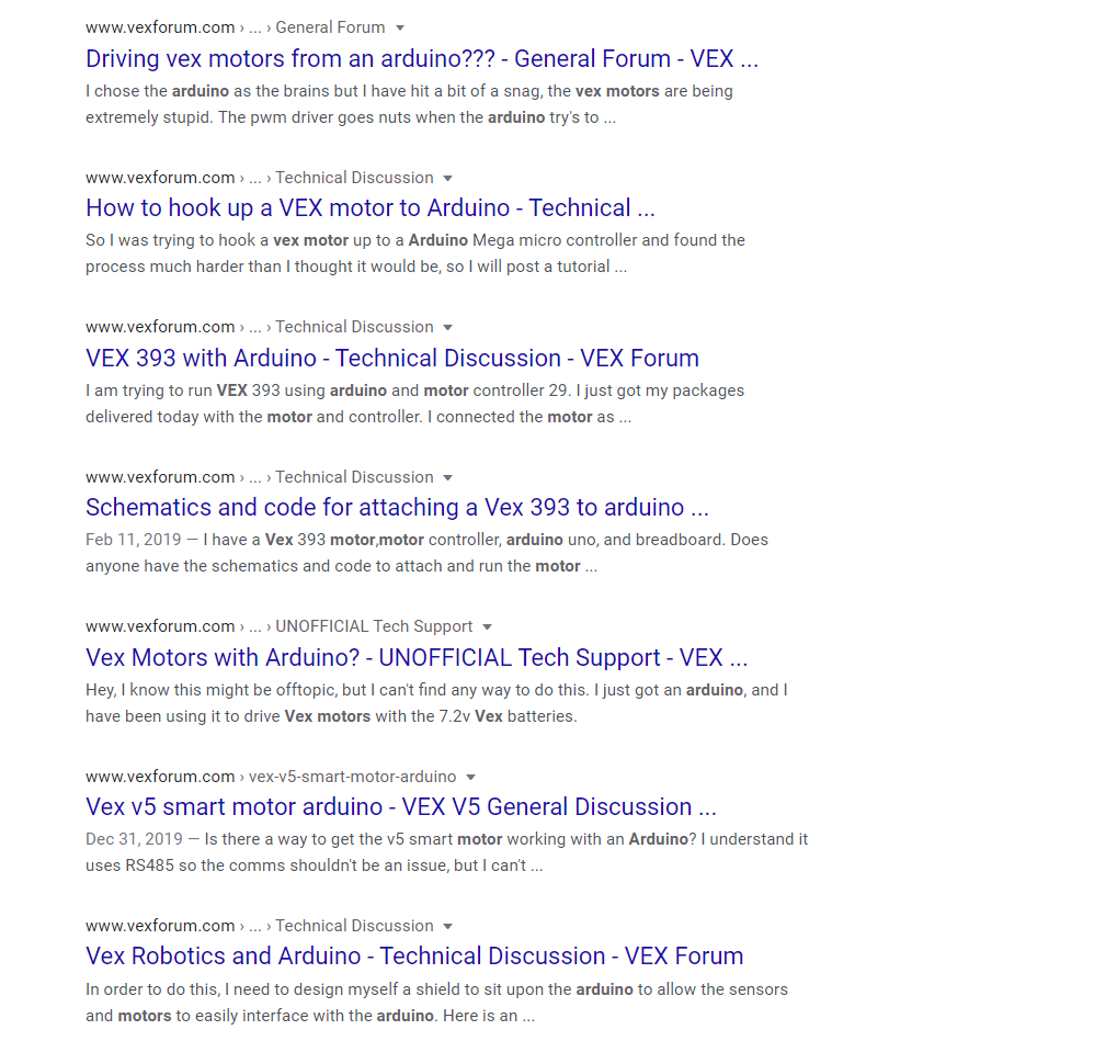

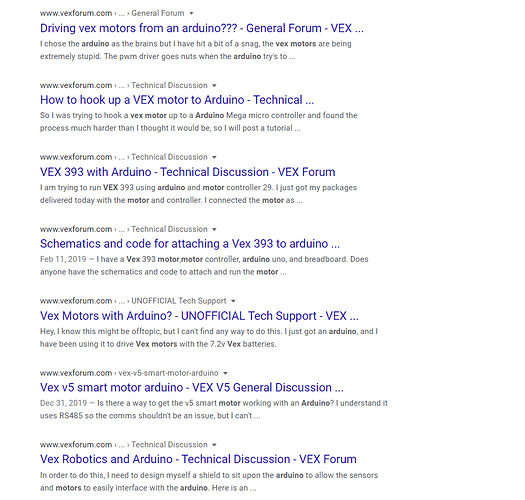

Honestly I was a bit worried, given all the new smart sensors, that you guys would stick with making everything “smart” even when it wasn’t really necessary.
I have used all the old vex sensors on arduino’s and it was amazing that they did everything using standard digital/ analog sensor convention. I can’t imagine it has a gigantic impact on the total VEX sales but you can see that people do appreciate that
There is a time and a place for a smart motor/camera. But there is room for a simple and elegant potentiometer that just does what a potentiometer does, change voltage based on rotation.
