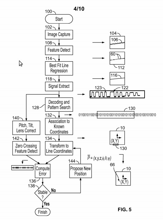

I spent some time digging through some of the details for this. It is pretty much done how I would do it. (Note I didnt read every page closely but I think I got the gist)
Take Picture
Find important corners from black to white squares, known algorithms solve this quickly in opencv etc
Take the positions in the camera image of the corners and fit a line between them, this is a line in image space that responds to the field perimeter
Given this line and the image actually construct the signal, which squares were black and which were white
Convert the signal of whites/blacks (1s and 0s) to the position on the wall those signals are located at
At some point calibrate the camera to account intrinsics (lens problems) Camera resectioning - Wikipedia and the extrinsics (where the camera is in space) https://www.ipb.uni-bonn.de/html/teaching/msr2-2020/sse2-12-camera-params.pdf

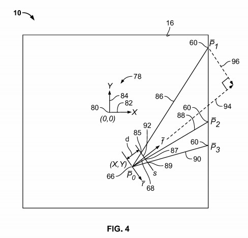

Then we go into an optimization loop using Newtons method, for those familiar with Gradient Descent Newtons method is Gradient Descents big brother.(Newton's method - Wikipedia)
How this optimization works is given any robot position (3D pose is 6 dof, 3 values for position and 3 for orientation) on the field we can compute what part of the wall we would be able to see.
Loop until the derivative is ~=0 and thus “stable” and future iterations won’t help
- Given an arbitrary position P we compute what we expect to see
- We subtract what we do see from what we expect to see given position P
- We compute the derivative of the function (what_we_expect(P) - what_we_saw) and the second derivative.
- move P in the direction that lowers that error P += direction * distance (cleverly while gradient descent pretends the error function is a line and moves down it, Newtons method pretends its a quadratic equation and computes this direction using this second derivative as well) direction =- f’‘(x)^-1 * f’(x) for anyone really curious how the derivatives work
For anyone curious, a normal computer vision course and some numerical optimization course would teach you how to do all of this. These courses are probably listed as something like 5000/6000 level in computer science and math respectively.

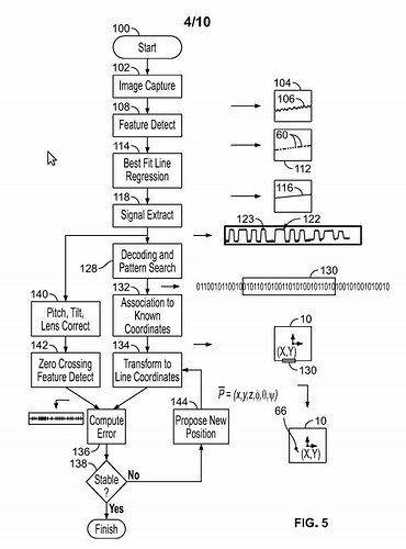

I am not sure what expected values that would imply. The way I understand the patent document - box 132 of their algorithm associates raw observations (pixel offsets returned by the camera sensor) of the feature points P1, P2, P3 with their expected (x,y,z) coordinates on the properly setup field.
Assuming there is no accurate analytical formulas to derive robot position from the optical observations, you will need to use numerical methods, and box 138 is there to evaluate the exit condition for stopping the iterations.
I don’t believe it uses position from the previous time step (as in solution computed 30 msec ago from the previous image and propagated with filter to present time) as the initial estimate. I think, it starts fresh with each captured image and makes very approximate analytical initial estimate. Then iterates by predicting what sensor would see given this position and computing how much it differs from the actual observations. If the combined error drops below some predefined expected accuracy value, it declares success and returns it as a solution.
You can argue that computational time could be reduced, if you start from a current position estimate out of the onboard Kalman Filter, which combines IMU and optical sensor observations to produce continuously evolving position estimate.
It could even be more accurate if it had access to the output of the motor control algorithm to predict any expected accelerations but, I think, the bigger source of error is the less than perfect field setup.
If filter had internal states to estimate field deviations, camera or IMU biases over time, then the subsequent observations could be much more accurate, after it “learns” about the sources of error by analyzing inconsistences between apparent observations and its internal model of how everything is supposed to be.
However, if the actual source of error is something else, besides what the algorithm was designed to look for, it could start to fail in strange ways. The filter may start pushing corrections into completely unrelated states and it will be very hard to debug and understand what is going on. For example, if it expects the coded strip to be within +/-5 deg horizontal tolerance and somebody sets up one side of the field with it tilted 8 deg - you may end up with something like reported robot position jumping 12" away from the real values as it turns.
In general, Kalman Filter is supposed to estimate only values that are observable and change with time. Multiple parameters that don’t change over time, like the field setup deviations, are supposed to be handled by the least squares type of calibration process and used to initialize the filter.
I am curious to see how robust V5 GPS algorithm (without calibration step) is going to be against the real life scenarios of multiple oopsies in the field setup. It may work great out of the box, or it may fail spectacularly when somebody sets up the field it the way that nobody from the VEX engineering team ever expected.

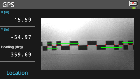

One of the dashboard displays will show an image with overlay of some of the field strip detection results. This is to help teams get the sensor aligned and seeing the field strip in a good position. Potentially that data can be made available, but it’s something I need to study and discuss internally.
Here’s a preview from a current beta, however, this may change for the final vexos release
