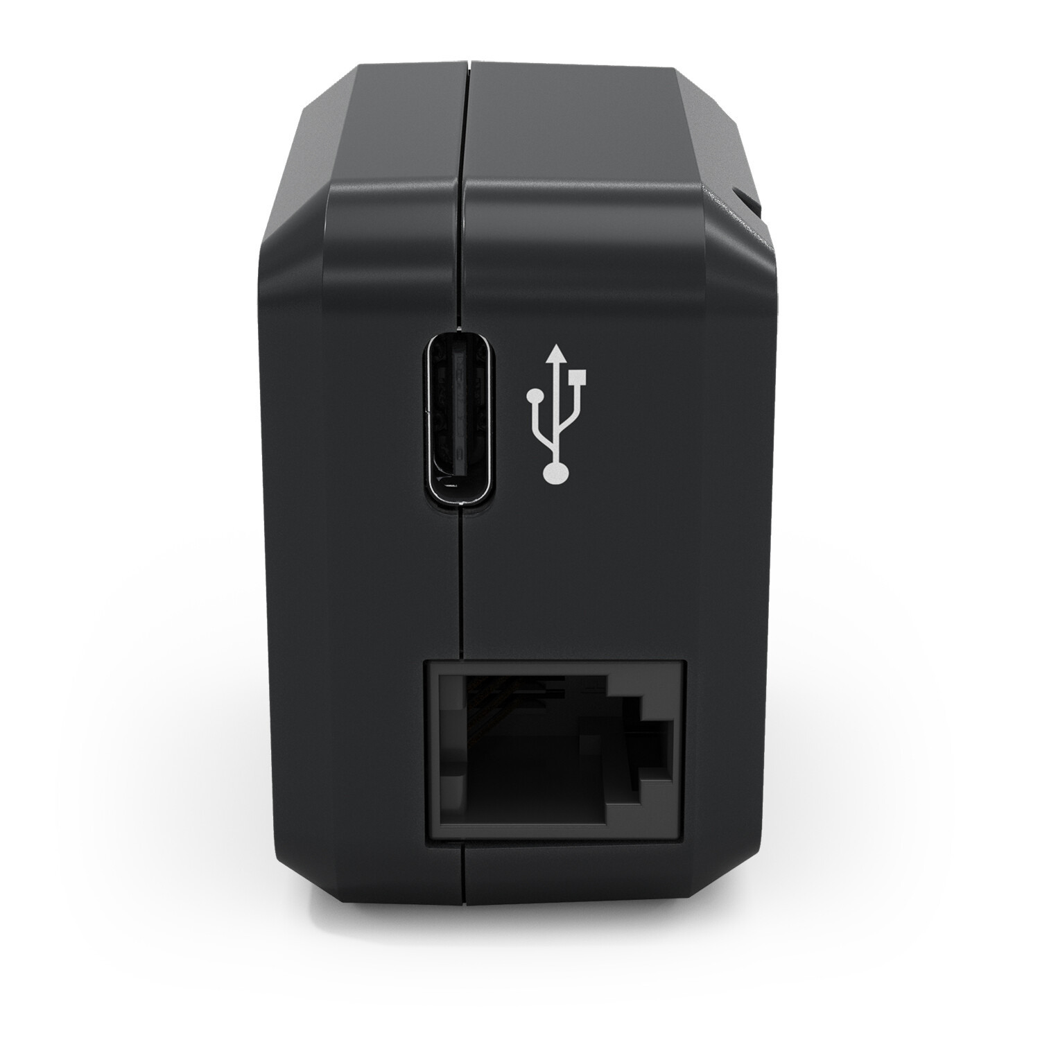

Some keen observers may have noticed that the Vision Sensor has been out of stock for awhile. We’ve been hard at work on a new and improved version, and I’m happy to finally announce its replacement, the AI Vision Sensor!
The VEX AI Vision Sensor is an exciting new addition to VEX V5 and EXP, providing powerful object detection capabilities. With AI object detection of various game objects, AprilTag detection, and color blob detection, this sensor elevates your VEX robot potential both in the classroom and on the competition field.
Features:
  • Color blob detection of up to 7 colors at once
  • Color code detection
  • AI object detection of generic VEX Classroom Game objects (Cube, Buckyball, Ring)
  • AI object detection of VEX Robotics Competition game objects (starting 2024-25)
  • AprilTag detection. Printable AprilTag will be available soon!
Notes:
  • Works with VEXcode EXP, VEXcode V5 and Visual Studio Code Extension
  • Color & Color Codes supported now in Blocks, Python and C++
  • AI and AprilTags supported in Python and C++. See VEX Library article upon release for more information
  • AI and AprilTags support coming to VEXcode Blocks with future software update
The AI Vision Sensor is available for purchase now! (On the US Store only, international availability will be rolling out over the next few weeks)
We can’t wait to see how our users implement this new sensor into their classroom and competition robots!

The aivision sensor includes an AI model for detecting certain objects used in a classroom setting. Later this year a new model will be available that will have next years game objects, ie. objects for the 24-25 season.
What are the pixel dimensions of the image this sensor assesses?
The data sent back to the brain is similar to the vision sensor, working resolution for objects is 320 x 240.
The sensor can stream video over USB like a webcam, that stream is 640x480.
This sensor does not have any WiFi.
