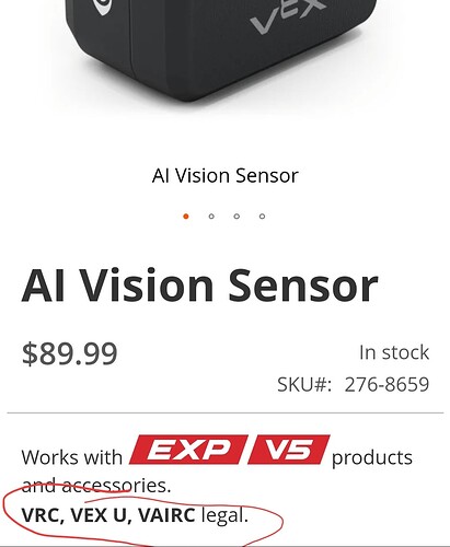

I inspected the rulebook and I can’t find the specific rule banning the regular VEX AI kit. The new sensor looks like it will bring a lot to the table as far as autos but I don’t see the rule banning basic AI kit. It is an official vex product that was released so it should be fine. I noticed on the product page that it doesn’t say that but what rule in specific. Also was confused because it should be VEX U legal I would think? Ultimately the newer VEX AI is cool and I have lots of ideas on the new ways for auto and for driver aid. I am interested on how integral the new April Tags on the field will be. I feel that this opens a door for a lot of cool game ideas.

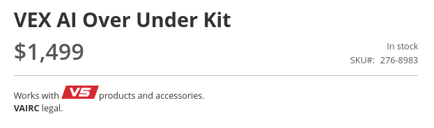

@EcstaticPilot He was talking about the VEX AI kit
@Liam_5405 the AI Over Under kit does not list itself as VRC legal, so R6 would ban it. Also, the VAIRC lists the VAIRC Kit components as VEXU “additional electronics”.
Yeah, but if you look at the kit product you posted its not VEX U legal, that’s why I was confused on this. The rule says that it must be listed in the rules, not about the website is how I interpreted that. There are ban lists in the rules that say what you cannot use and the AI sensor is not listed. That would qualify it per R6. technically I could use the AI kit (almost any judge would still say no) but per the rules I think it is technically legal. Any team that tries this will probably be disqualified but I think that the rules are worded in a way that permits this. Its tough and I give RECF the benefit of the doubt because its newer product (although there is a rule for that) but I think come 24-25 we should try to get more defined rules on crossover.
TL;DR The rules say that V5 products are only banned if they are on the list. I think that needs more work. VEX AI kit is legal?

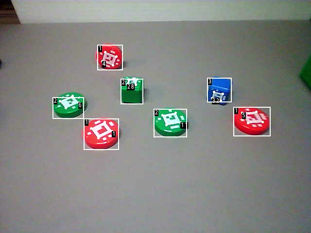

So you can generate them yourself, print them and stick them onto objects/places you want to be seen. They are squares of about 6 inches per side (I think recommended by the creators). Then software tracks it and calculates coordinates just like the old blobs on the old Vision Sensor.
Here’s an example.
This is a screen grab from the USB video stream with the overlay enabled.
The discs and cubes are small, about 1 inch across, these are used with the CTE workcell.
The monochrome target in the back is about 6 inches square, more likely to be used in a VRC game if that ever happens.
V5 dashboard would show this if tags are selected as the object of interest.
or with a slowly updating background image.
apriltag processing is very cpu intensive, it’s a challenge to have it run on a small embedded processor. The AI Vision sensor’s lens also has a fairly wide angle of view, the limit for detecting the 6 inch target with default settings is about 6 feet as beyond that is doesn’t occupy enough pixels in the image.
apriltag processing can also run while color detection and/or AI object detection is enabled. As color detection is far less resource intensive it’s likely that the output of both algorithms would be used together to track objects.
Another USB screen grab with color detection and apriltag enabled.
