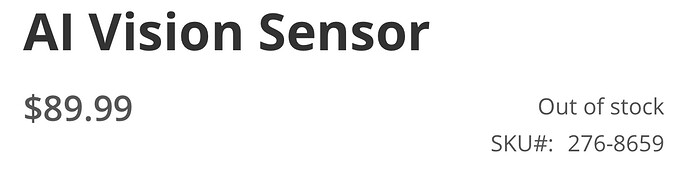

:frowning:
@bkahl is stock expected to improve in the short term, or are we in for another pneumatics experience? Either way it would be better to know just for planning reasons if for example we should expect to be able to get these enough before worlds to integrate them.
