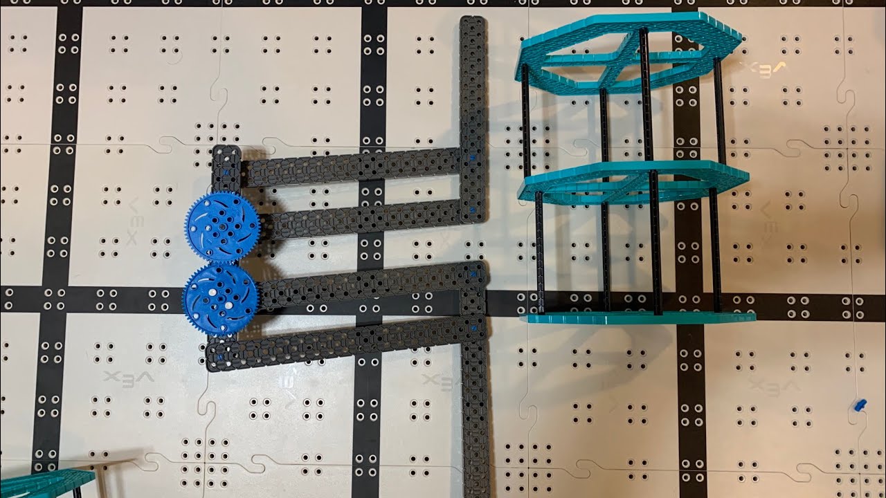

How does your bottom claw align the risers with the side you pick them up from?
The pusher is really the magic to that. The front of the robot (the pusher) evolved over time to what it is now. For this robot, this is probably the part of the robot you’d need to copy exactly or at least pretty closely.
When you drive into the risers, it is designed so that the risers automatically turn and go to the correct position for pickup. The key is that the robot reacts against the middle plate of the riser, not the standoffs. This ensures that the risers can’t get stuck in the front of your robot. It’s kind of hard to explain, but I think you’ll get the idea. Let me know if you have questions.

If you only used one motor and rubber bands to move the 4-bar for the robot that scored 210 points in skills would it still work just as well when you’re lifting risers?

Oh I really want to make a drb4 but don’t know how. Could someone give me some close ups of their robot?
Is that for this competition?
I really want to make a dr4b but with three arms. Like your first bot, sandstorm. But just a dr4b instead.
i think it would be good because the risers would all come down in a straight line
You might make yours better than mine, but I’ve tried this and I realized that it doesn’t exactly work well, especially compared to the metas. It’s heavy and you don’t need to go as high as it allows. I think that a regular 4-bar would be easier and more efficient.
If you really want to make one though I found this video. It has some close-ups and will give you the basic idea.
k thank you 20 chara
There is also the DR4B tutorial that was made by 333A. It’s for VRC but it translates over to VEXIQ.
Probably not, but you could try it. It is already loaded with rubber bands, and also, what would you use that last motor for? There is no room for an H-Drive on a robot that small. One reason that I could see would be that it is lighter and so it is faster, and that could definitely help. Let me know how it goes (I haven’t tried it).
