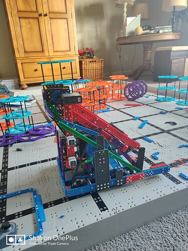

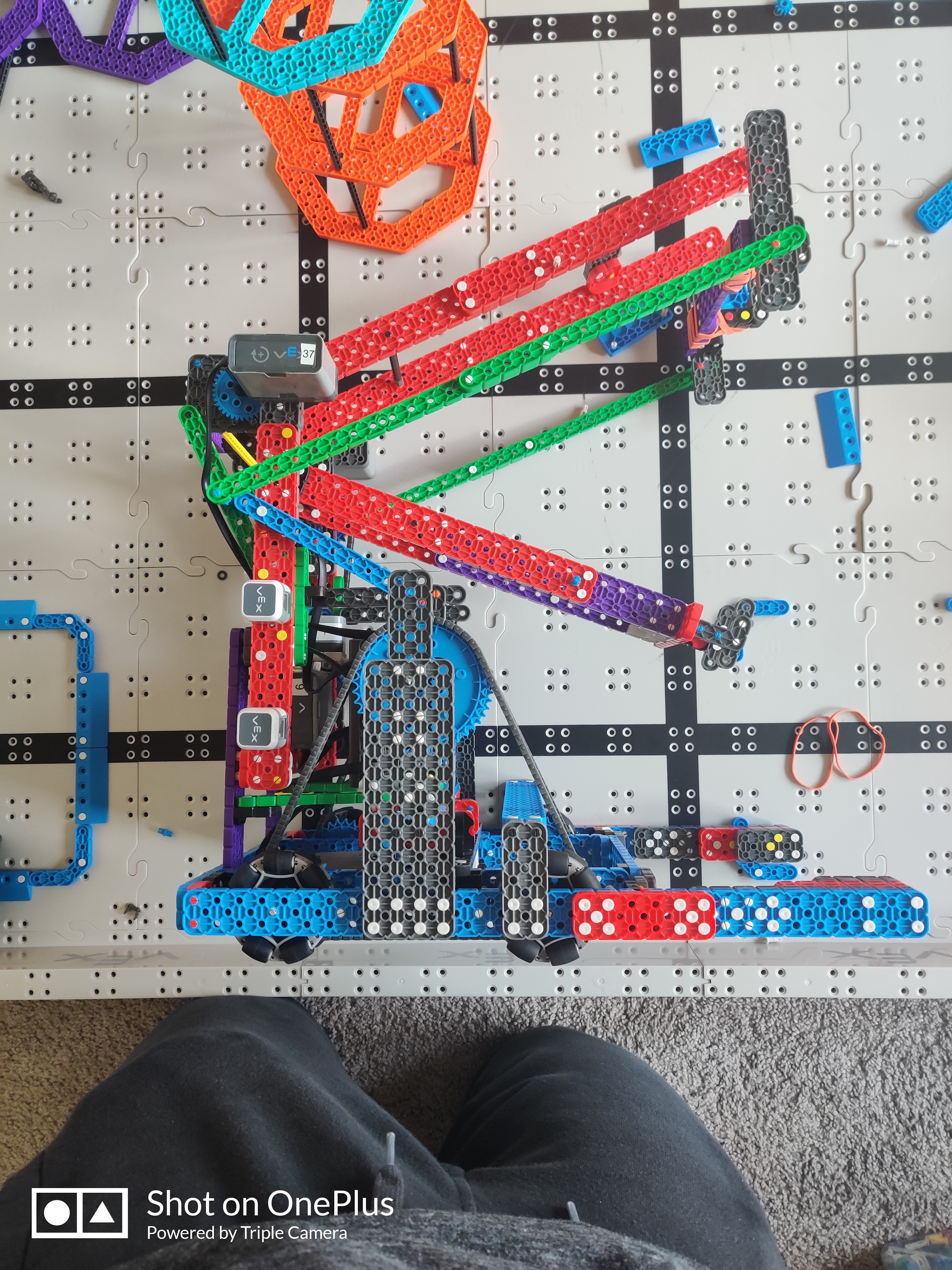

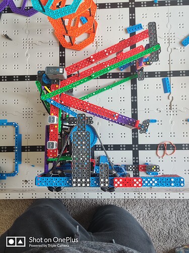

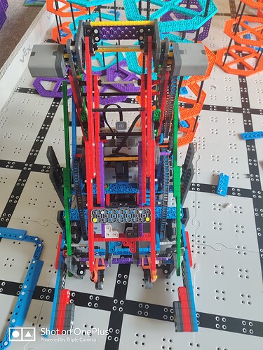

Does the drive train that isn’t symmetrical for your 210 skills robot require additional coding? I’m curious how it works.
Although the drivetrain is asymmetrical, it does not require any special or different coding. If you think about it, the gear ratio is not any different, and neither is the code.
Also, even though we did a very skinny drive base (you can’t get any skinnier without having major problems), I would highly recommend that others do a wider drive base for ease of building. This design takes intense packaging, and a lot of work. A 10" drivetrain would work nearly as well, and would be a lot easier to build than our 7" one.

this is our robot btw!
