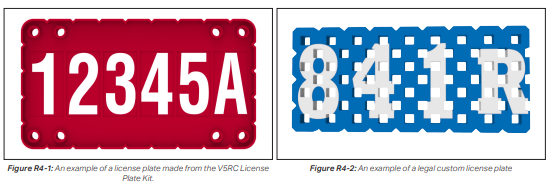

Regarding your point on profit, custom license plates are actually still permitted under rule , provided they follow the specific size and legibility requirements.

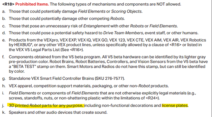

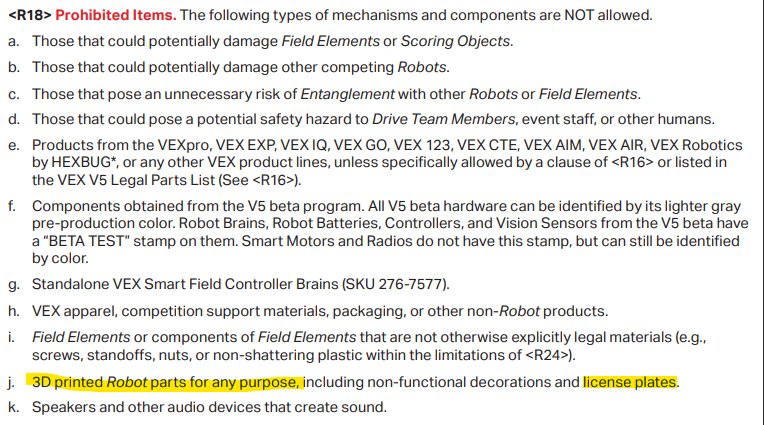

You can in fact use custom license plates under R4. They just cannot be 3d printed, and must meet certain criteria.
Before you say someone is spreading false information please double check your own facts.

actually this time ima defend the guy. license plates don’t have to be 3d printed they have to be vex parts tho

The main problem is coloring the fake plate to make it red or blue with a vex-legal component. Because of this, any custom plate is illeagal. You can still have custom decals on the normal license plates, but not custom plates.

You do have a point here, I didn’t think about how you would have to recolor parts to make custom license plates, I do think that this will need to be clarified as an exception to the no coloring parts rule, but I still think you can have custom license plates by just putting a big sticker on a plate or something.
Yeah, I didn’t think of that. This is probably legal
