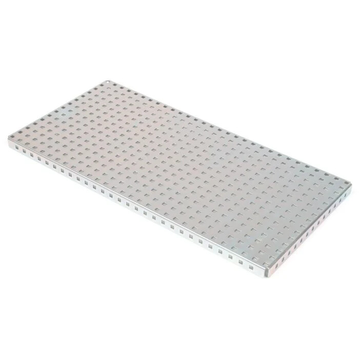

This would not be a good thing for a drive train, I would most likely look at getting aluminum c-channels or 3 wide ones.

bro don’t give people false information, @Ramachandran_Ramaswa DO NOT BUY THIS
Seriously don’t. Those plates are steel and are very heavy. Unless you are willing to take the time to cut this piece into smaller ones, do not buy it. No point of a sheet that large and is a waste of your money. Listen to TibTy.
