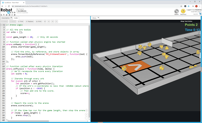

Now available for everyone on Robot Mesh Studio https://www.robotmesh.com/studio is the mimic arena project type.
If you’ve used Robot Mesh Mimics before, you will be familiar with how you can construct a robot within the mimic editor and control it with your program. Now with Mimic Arenas, you can construct the arena separately from the robot and share it with your students and friends.
Moreover, mimic arenas can contain logic, written in JavaScript for controlling game timers, scoring and movement of arena components.
An example can be found online here: https://www.robotmesh.com/studio/5e7e7e2d37a45538e464106f
