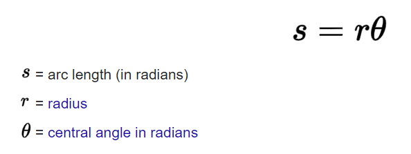

That is correct. The arc length formula is this:
Arc length: distance traveled by the mid encoder
Radius: distance from the mid encoder to the center of rotation
With these values, you can calculate theta. Then, you can compare the arc length theta with the actual rotation of the chassis and figure out how much horizontal distance the robot actually traveled.
