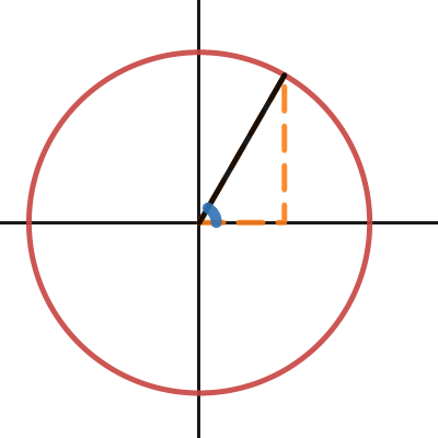

The math actually doesn’t need to change when you are going in reverse. You are right that triangles can’t have angles greater then 180 degrees, but it is still fine to make the angle go above 180 because we aren’t just solving for a triangle normally. We are instead using a unit circle, which is a circle with a radius of 1, and the trig functions allow us to turn any angle into an x and y position on the circle (image below)
When the robot is at any angle from 0 to 90 degrees the trig functions both give positive values, meaning it is going up and to the right. Then when the robot is going between 90 and 180 the x position becomes negative, meaning it is going up and to the left. This is what we want, because then the odometry still works when the robot is going at any angle.
Here’s a interactive desmos graph which should hopefully help explain it if my explanation didn’t make sense:

Ok, sorry for all of the messages, but I started to read even more on odometry in the vex forum, and it seams like I am calculating the y values wrong. Here is a desmos graph explaining the math I believed I was using - Odometry | Desmos. I found it from this post - Odometry Code? - #21 by iseau395. In this desmos graph to find y you need to do sin (theta + pi/2) * difference between left and right wheel position. However now I am confused because what I thought was that I had the length of the hypotenuse and to find the length of the opposite and adjacent sides of the triangle, or the x and y position I just use cosine and sine like I explained 3 posts above.
Yeah the math for the unit circle and for triangles is actually two different visualizations of the exact same thing. You don’t need to make any changes to your math besides removing the part where it checks if the robot’s rotation is > 180 degrees and swaps the trig functions, I just brought that up to help show that it still works with angles more then 180 degrees. Odometry can be done with arcs but that’s a lot more complicated, and honestly not that much more accurate (my team has done both). Sorry if I confused you
