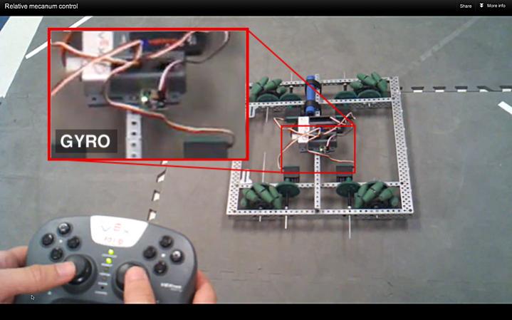

I did a very quick implementation in ROBOTC of the code from the referenced paper in my previous post. I’m not going to post the whole program here as it contains several other “work in progress” libraries but the drive code ended up as follows.

It’s not very useful out of context, there are other tasks running handling the gyro and motor control but it gives an idea of how the code would be. It actually works really well.
