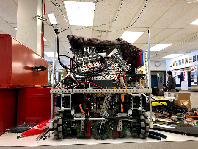

You should try to go with two pods and the air tank.
You will be surprised how much stuff you can squeeze into the chassis once you start thinking outside of the box.
2381X and 2381C Turning Point Post-Season Reveal
