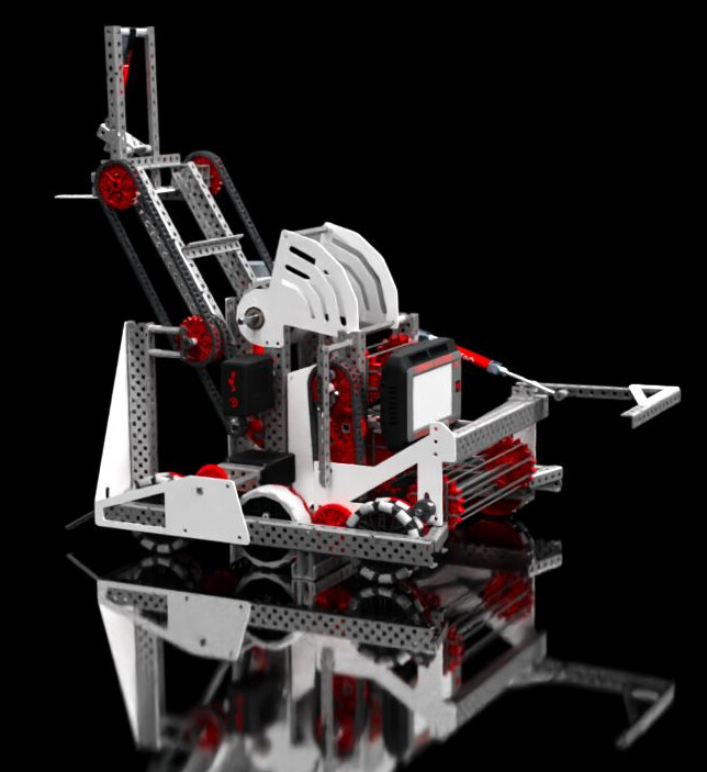

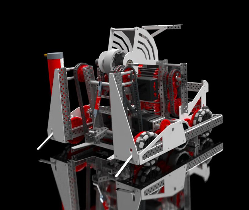

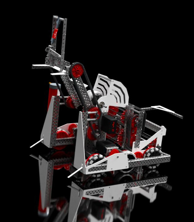

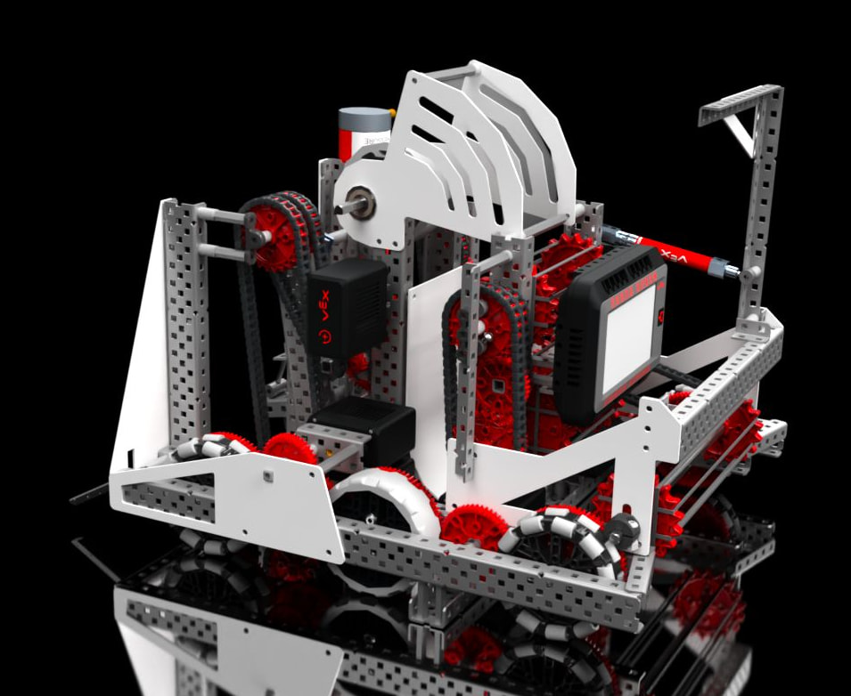

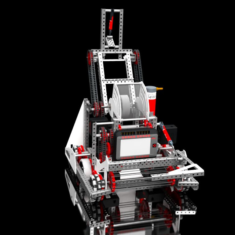

Heres a robot I cadded for override based on my predictions from the game name reveal. I was thinking it was gonna be stacking or shooting so I might as well do both. I was also thinking it would be similar to turning point with balls as the main elements that need to be shot somewhere, with some kind of thing to be lifted and place
It has a double ratcheted front intake to index and feed balls into the flywheel, which is also double ratcheted so that the motor powers the chain bar lift. I also put wedges at the back for defense and a little piston doinker because why not
66w 400 3.25 in. chassis
11w 600 front intake double ratched to shooting indexer
11w 3600 rpm flywheel double ratched to 40 rpm chain bar

Nice, looks like 169 TuP with a lift on the back lol

Welp I guess this is quite innaccurate now except for the lift but that couldnt even grab any of the actual game objects
This looks great. Quick question, what CAD/Rendering Software do you use to make it look so good?
I used Onshape
