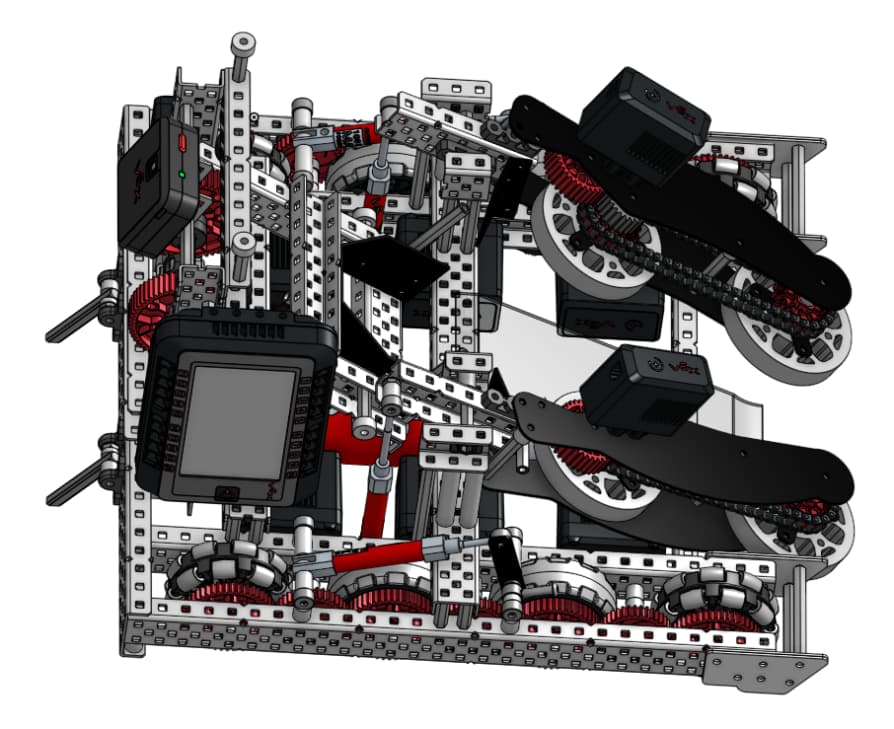

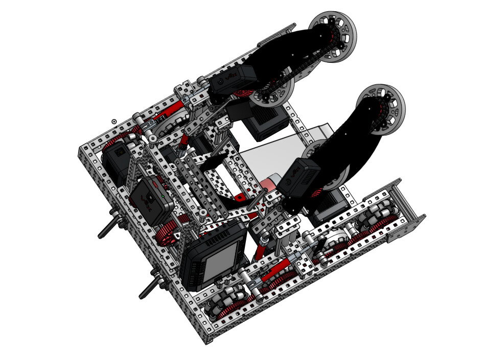

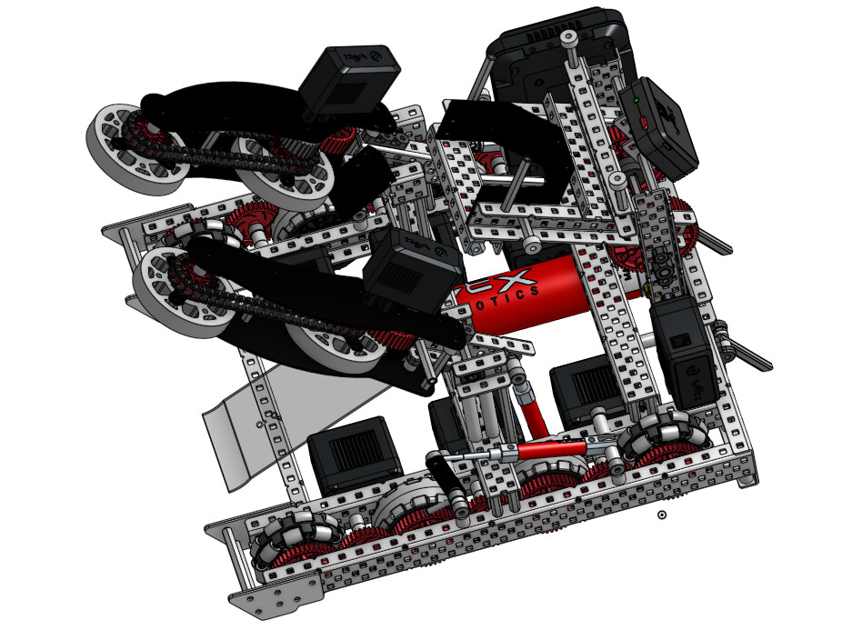

Here’s a robot I cadded based on my predictions for push back.
I think the game object will be balls of some kind that you need to score in baskets or buckets of different height.
It has:
A side roller intake similar to change up for picking up balls
Lifting intake to score on higher baskets
a catapult to score on even higher baskets
pneumatic drive ratchets/breaks and wedge for pushing other robots back (haha push back) for maybe a possible king of the hill style end game like turning point
Sleds for crossing some sort of platform
6 motor chassis 450 2.75 in. wheels, 2x 5.5 watt motor intake geared to 300 rpm, 1 motor catapult 20 RPM
Overall it looks good, but you will recall that in Over Under the initial thought was 2 horizontal rollers, which transitioned quickly to 1 vertical roller, so a similar fate may come upon your robot design.
I want to say I like your energy, designing a robot based on a game name.
I like the arm design and the compact 8 wheel drive base. Lots of mechanicals in a small space. Looks like a good teaching robot for other teams. Thanks for publishing the multiple views.

is the piston above the gears for the wheels a brake?

how do you make the lifting intake
Looks like onshape
They used pneumatics.
