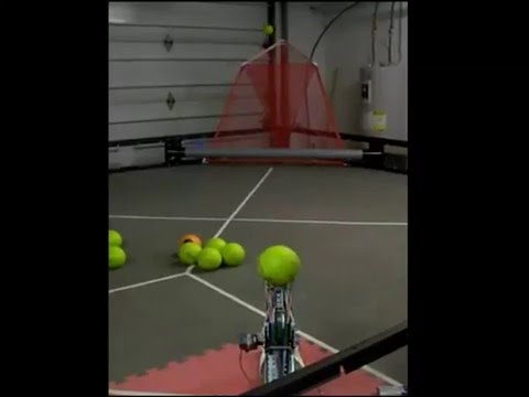

To start the discussion, here is video of our prototype shooting 20 balls in 30 seconds.
It is a “classic” design with 36-6t slip gear driven by a single high-speed motor via 12t pinions. It is not very accurate in the horizontal direction, since it wasn’t mounted on the robot. Actually, I was surprised that so many balls made it into the high goal despite the cavalier way technik jr was loading them.
An important takeaway is that a single motor provides enough power for sustained full-court shoots every 1.5 sec. In fact, when run by a single turbo motor it could still launch about 30 balls at a rate of 1.2 sec per ball but then PTC would trip.
Another important note is that this puncher uses quite high parabolic trajectory which makes it less accurate with the balls of varying densities. To ensure the high accuracy you may want to make it overpowered, shooting at the lower angle directly into the high goal.
