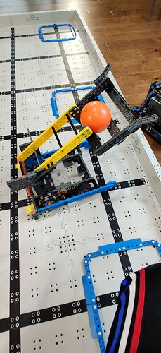

concept was to be able to scoop balls into a tray and then launch it. So far has not worked

I wanna bring this thread back to life, purely because i think I am running low on ideas. Don’t know what I am gonna do if this next design doesn’t work. I copied the large dumper robots short drivetrain onto a large hopper that expands via dr4b with a catapult launcher.

Flywheel bot:
2 motor, 4 wheel drive
1 motor intake, rubber bands
1 motor indexer, rubber bands
1 motor flywheel
1 motor hook arm
Dump bot:
1 motor intake
1 motor lower arm
1 motor upper arm
1 motor hook wrist
