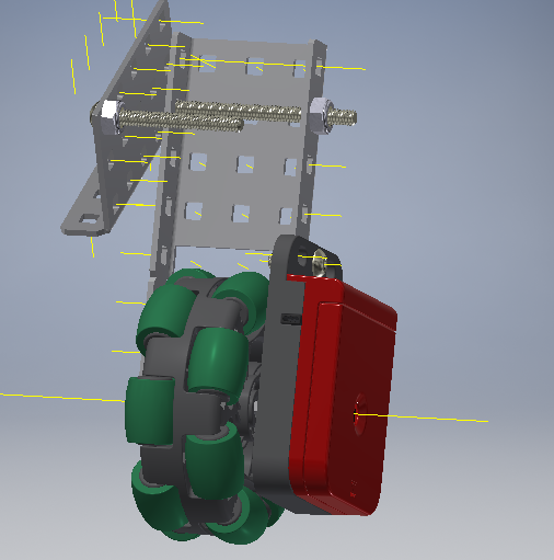

also this is what i have rn in inventor do you guys recommend me putting more support on the other side of the encoder?
I used a hacksaw and a small vice to make the cut. The way I did it the other halves were not usable because I wanted to give the wheels as much support as I could so made the cut as far to one side as possible. I tried to avoid cantilevering to reduce friction from added friction introduced by any angle in the axel. It’s perfectly acceptable to do it either way, but I wanted to keep things as compact as I could because 3 tracking wheels add up. :​)
