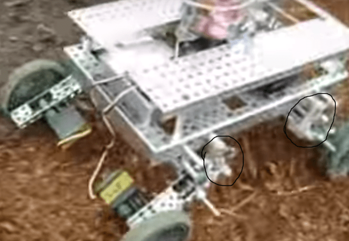

i found something like this but cant really understand whats really happening because of the quality
maybe you can see something ?
I don’t actually see it, but that looks like it would have rubber bands pulling each arm down which acts as suspension when the bot hits a hill
EDIT: I do see it, it’s closer to the center of the robot in relation of the pivot.
yea i think i see it now
