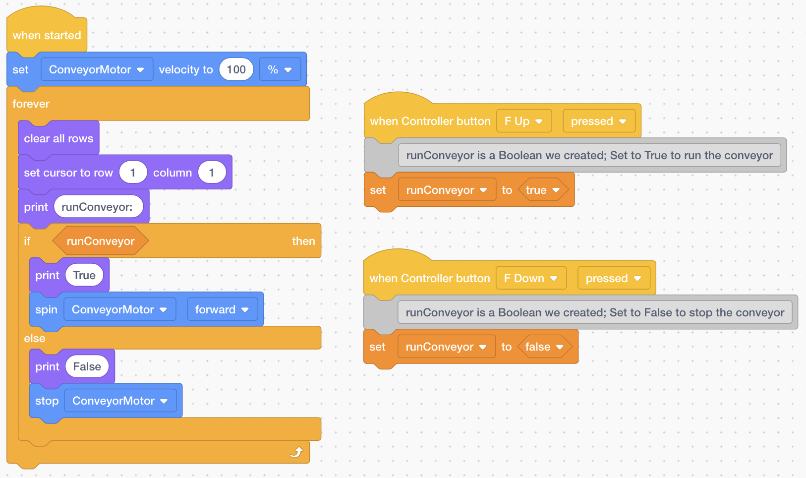

Have the button change a variable from on/off. Then have the motor run based on the value of the variable.

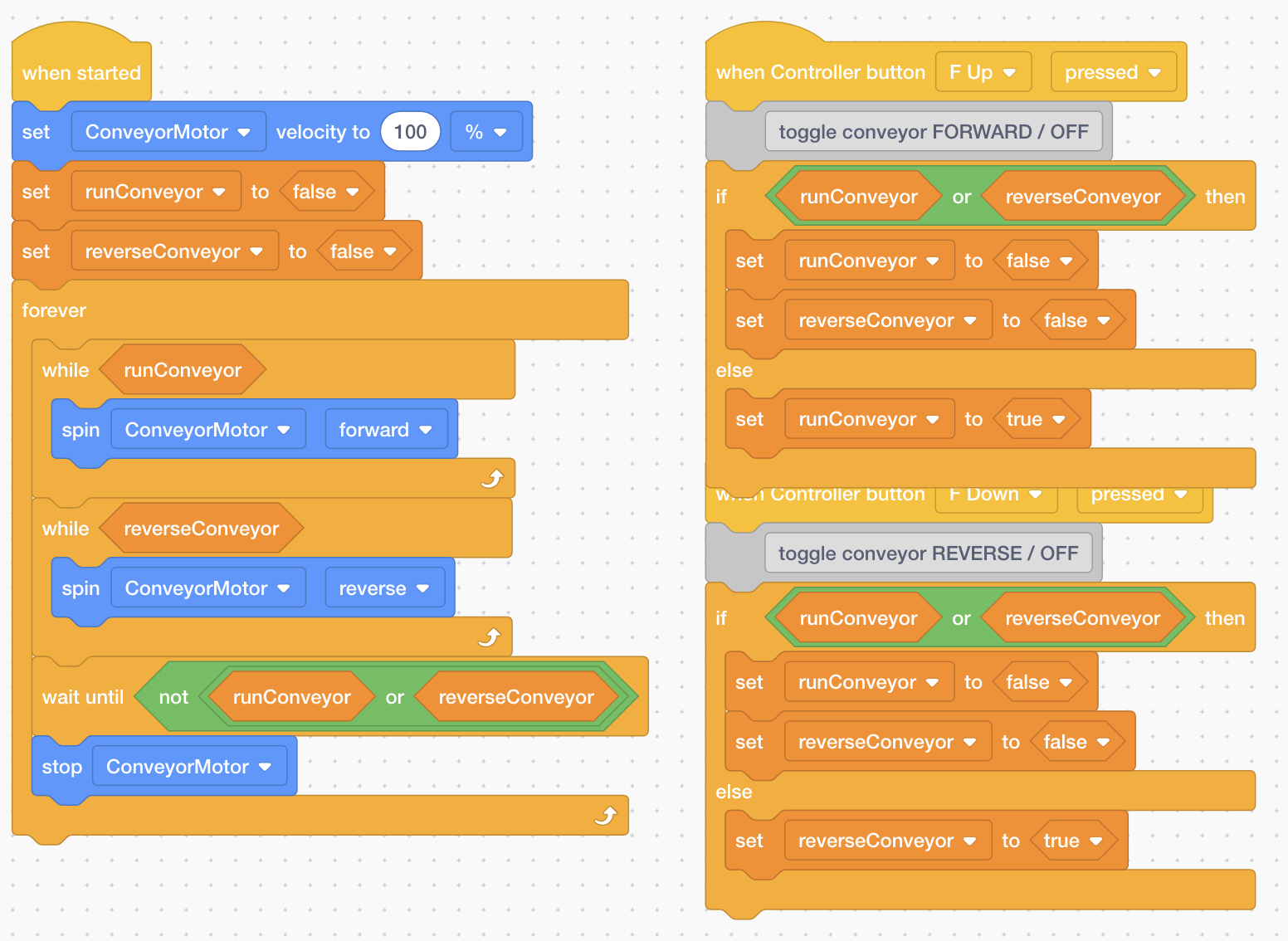

You can do something similar on one button with code that goes something like.
When Controller F Up Pressed
If(runConveyor = True)
Set runConveyor to False
Else
Set runConveyor to True
This will allow the F up to toggle between True and False and then your forever loop on the left side of the above code will pick it up

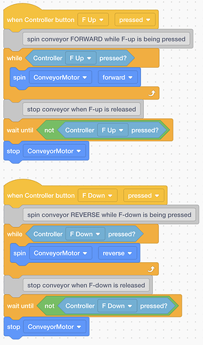

Yes, I try to teach the roboteers that with fingers off the controller the robot completely stops. Referees hate it when they say 3-2-1 stop, controllers down and parts of the robot continues to move. The code that I showed has the conveyor stopping with fingers off.
Ahh. Again, there are multiple ways to do this, but if you need to also reverse the conveyor, this might be the simplest method:
@Foster - I can understand that, but if you have an intake conveyor that you want to run for almost the entire match, it isn’t practical to expect the kids to drive the entire match while holding down a button. Especially F-up, which would tie up their right thumb so they couldn’t use the right joystick. There is definitely a place for toggling on and off.

If you’d rather not have to hold down the buttons, you could do this:
