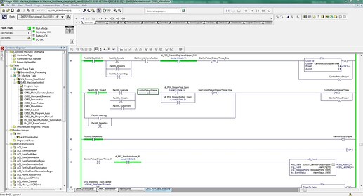

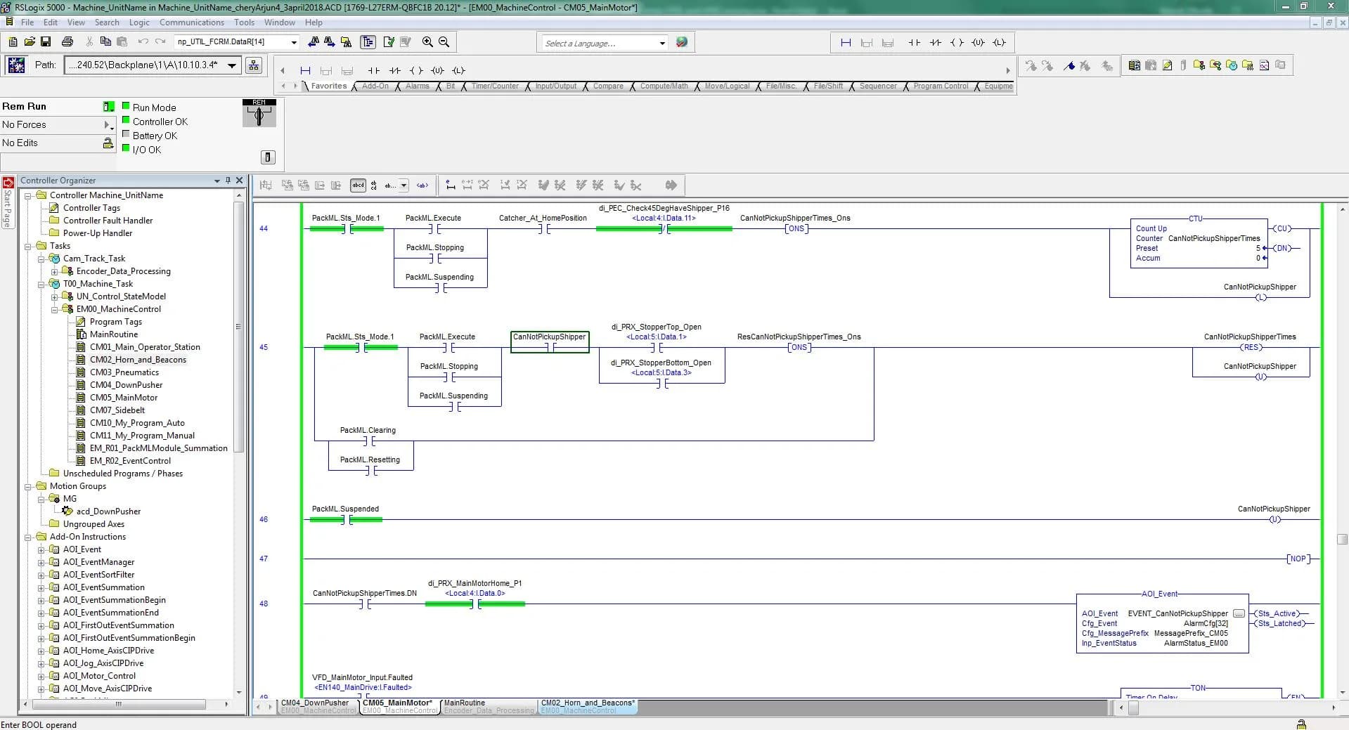

Hey there, guy in the future who has a CS job here. As much as I dislike VEXcode blocks, block or more widely, visual-based programming actually has many different forms in the professional world. Some good examples are programmable logic controller (PLC) ladder logic packages like Rockwell’s Studio 5000, the most commonly used software in the automation industry.

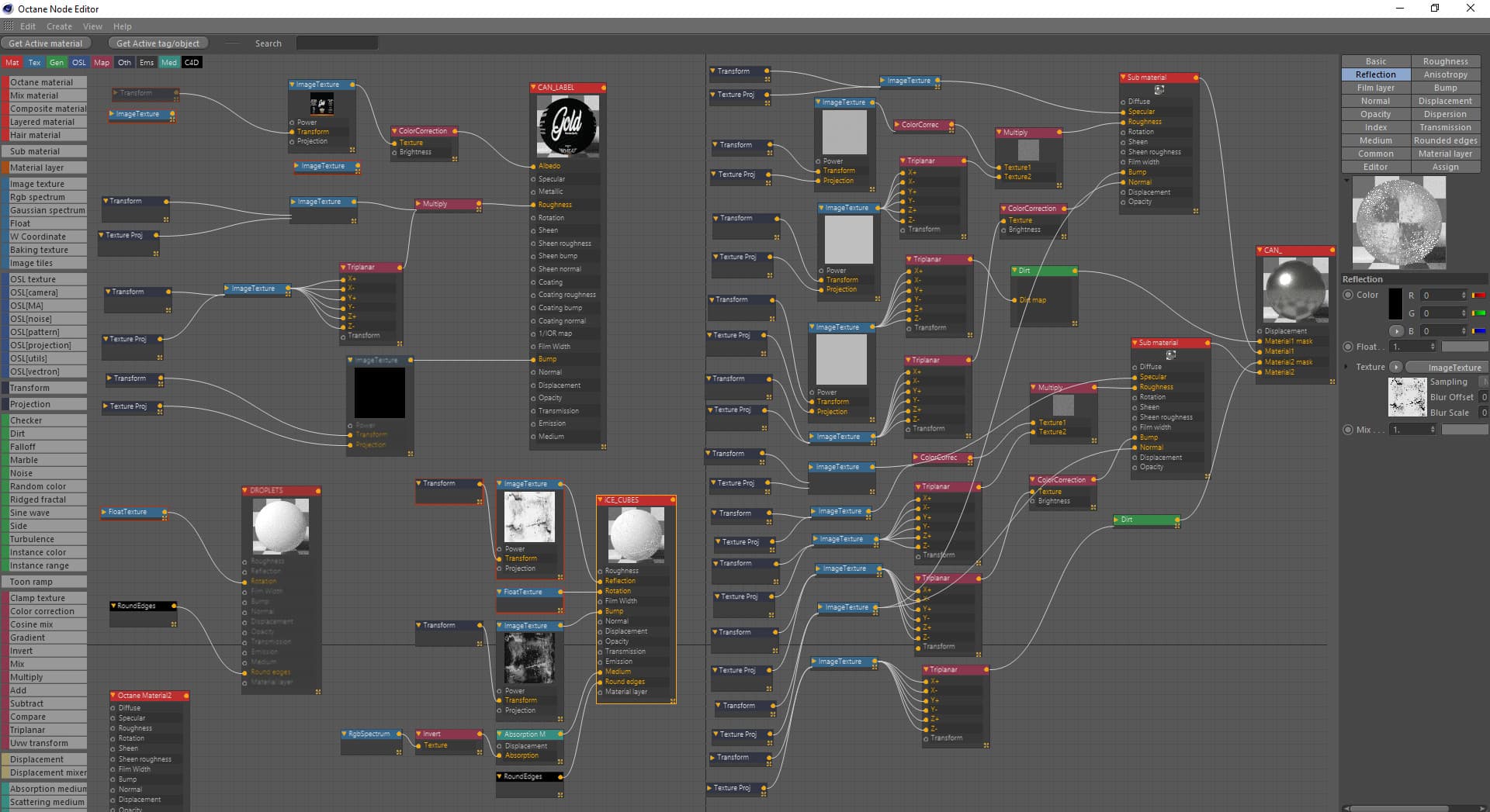

There are countless nodal programming platforms as well. Blender (3D modeling and animation), Autodesk Dynamo (architecture and BIM), and Unity Node Editor (games and whatnot) are good examples from many industries. This:
Produces this:

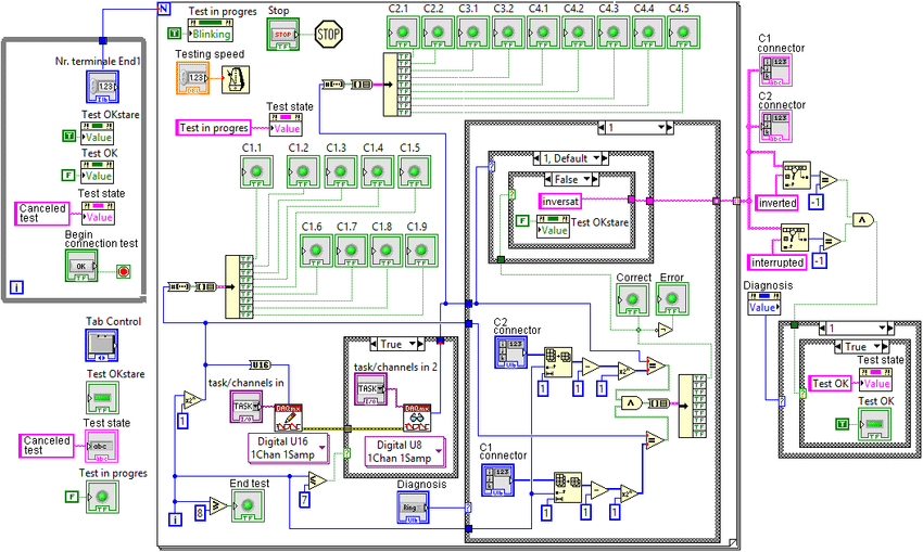

The CGI, AV production, 3D modeling, and factory automation industries all rely on visual programming languages. On the engineering design side of things, LabVIEW is used to simulate electrical and control circuits for all sorts of things.

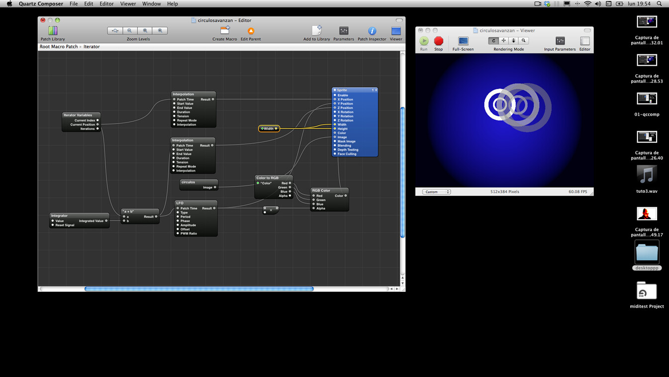

I used to spend many hours using Quartz Composer a few years ago, great tool, shame it was discontinued.
That’s cool. I didn’t actually know that visual programming was that widely used professional settings. (And completely forgot about a game that I made in a program that was quite similar to unity node that was decently popular. :man_facepalming:)
