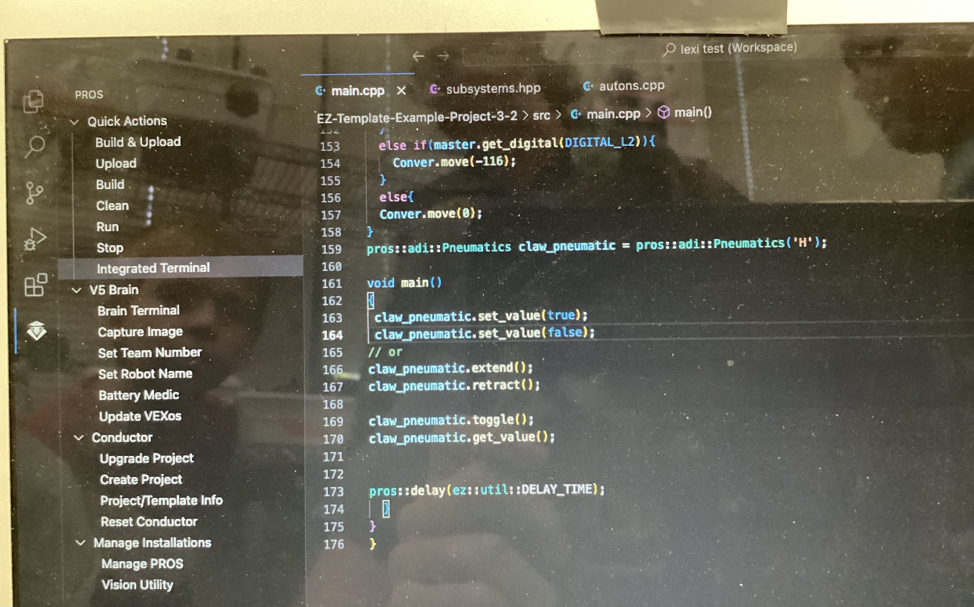

I am a first time coder and trying to add my pros into my code but I don’t know how. I feel like I have already tried everything I could find online. If you know how to code in pneumatics in pros please let me know how.

For pros 3.8.0 (older version): ADI (TriPort) C++ API — PROS for V5 3.8.0 documentation
pros::ADIAnalogOut claw_pneumatic = pros::ADIAnalogOut('A'); // Create a pneumatic in port A
void main()
    claw_pneumatic.set_value(true); // Extend
    claw_pneumatic.set_value(false); // Retract
For pros 4.1.0 (newest version): pros::adi::Pneumatics class | PROS for V5
pros::adi::Pneumatics claw_pneumatic = pros::adi::Pneumatics('A'); // Create a pneumatic in port A
void main()
    // OR
    claw_pneumatic.extend();
    claw_pneumatic.retract();
    claw_pneumatic.toggle(); // toggle the pneumatic
    claw_pneumatic.get_value(); // get it's current state
This is what I have tried can you tell if there’s something wrong that I can fix.
you haven’t been very descriptive of what you actually need, nobody can help you if we don’t know what you want. Do you want to extend the pneumatics once? Have it toggle on a button press? Something else?
Also, what I sent is just a list of everything you can do with the pneumatics, not something you can copy/paste in to make it magically work. If you want to extend the pneumatics, you only put in the extend line, or to make it retract you only put in the retract line, etc. The top line is the definition of the pneumatics, so you put that wherever you made motors and other devices

I’m on her team and we did coding before and robotics and we needed to use pros we just don’t know how to code pneumatics
It needs to be used multiple times in a game
