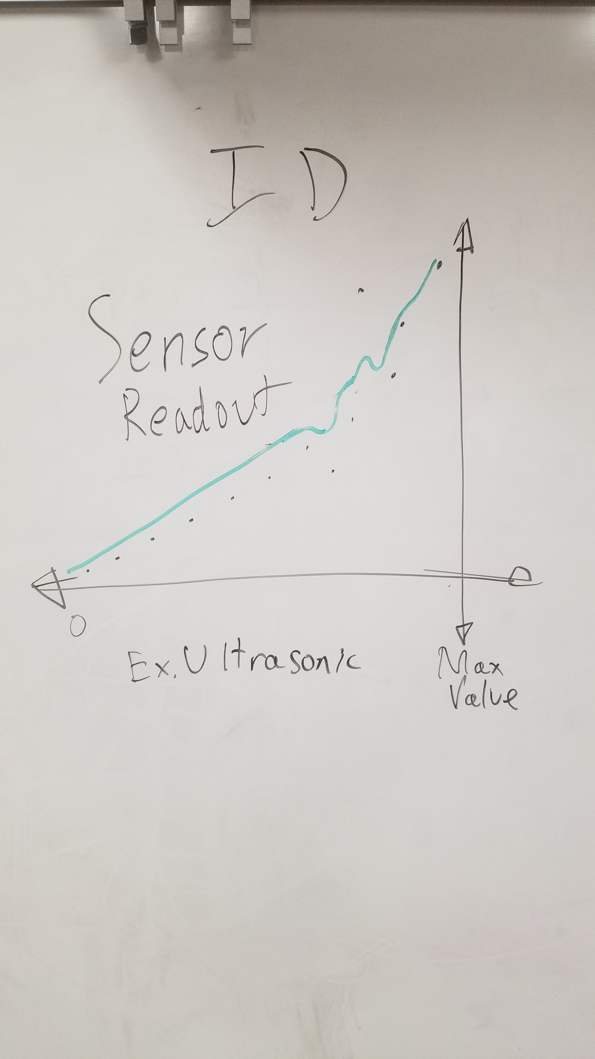

What about adding integral of derivative to the motor. Wouldn’t it be even more precise, as there may be a constant error rate, when tilting the tray, such as the weight of the cubes.

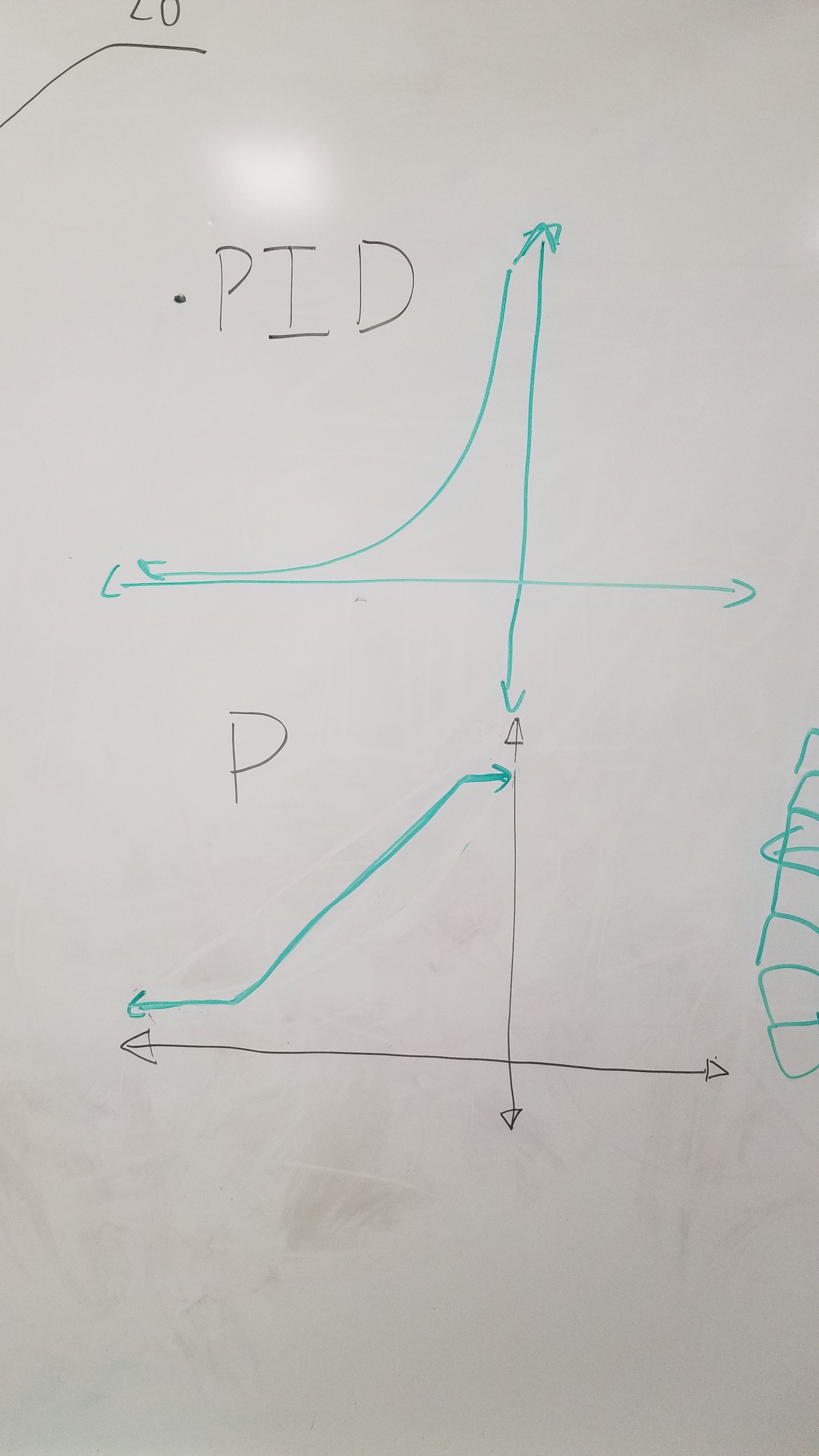

P control moves down motor power as the rotation nears the limit. rotateFor (on vexcode) is blocking, which doesn’t play well with drive controls. And I don’t think V5 PID ramps down, which is why some bots last year would fling the rear of their chassis up after they brake, because there’s no ramp down.
E: changed PID to V5 PID. I don’t think it’s actually PID, though. Just a spin loop.
I feel that’s extra math for this problem. The ID control would make the rotation values I’m recieving from the motor more accurate but I don’t think that’s neccesary
And I think this is Integral Derivative. The black dots are the actual readout per cycle and the green line is the smoothed value.
I think it really just depends if there is or isn’t steady state error.

This is incorrect. PID does ramp down much in the same way that P does.
Braking is an entirely different discussion. So is using this for drives (which are more complex to control than other mechanisms, because they are 2-dimensional). Built-in PID works fine on things like arms and lifts, in my experience.
To be clear: what algorithm you use does not affect the accuracy of the encoder data.
This is not an accurate depiction of how either algorithm performs. Both will be relatively smooth curves, which will reach the target gradually. the “I” term ensures that enough power is given to overcome friction and other resistances in the system, while “D” ensures that it ramps down enough and avoids oscillating.
I’m not sure where you’re getting the data for these graphs from, but these aren’t accurate either. Firstly, V5 “PID” is in fact real PID, and does not just give a constant voltage until it reaches the target. It may not be perfectly tuned to your use case, but a) the tuning is technically modifiable (though not recommended unless you know what you’re doing), and b) it’s never going to be that flat of a line anyway. I’d suggest grabbing some real data from the V5 and graphing it in Excel or equivalent if you want representative graphs.
The PID graph isn’t accurate because the D term will reduce the voltage as the velocity increases, to avoid overshooting. If you’re seeing a graph like that in real life, your I coefficient is definitely way too high. Also, on both the P and PID graphs, you show the voltage starting at 0, which isn’t accurate; while they both ramp down, neither ramps up. They should both start at a fairly high velocity, and P should be pretty linear (depending on what your x-axis is).
Unfortunately I don’t have access to a V5 right now, but I’ll try to gather some real sample data when I do and graph it.
Thanks for the detailed answer. I’ll try rotateTo for tilter rotation again.
