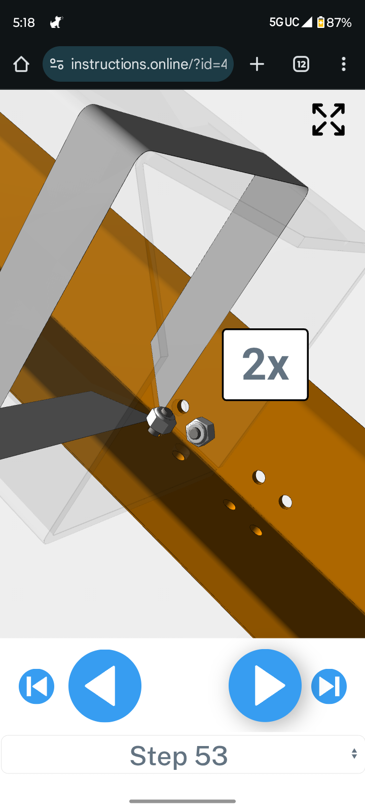

The animated instructions for assembling the high goals show the clear tubes being mounted with 0.5" screws inserted from underneath, mating with nylock nuts on the inside.
We found that this wasn’t doable; the screws themselves came together in the center, and there wasn’t room to get the nylocks on. So we put the screws through from the inside out. I suspect other teams may be doing the same (based on a very limited review of RiXh videos).
Having the nuts instead of the screw heads protruding into the channel might present somewhat more obstruction (though I doubt enough to make much difference to descoring).
So, how are other teams assembling these joints? And are they actually supposed to be screwed from the outside in?
Your supposed to attach them with an offset diagonally.
Ah, OK, makes sense. I didn’t pick up on that rotation of the figure. (Not clear why there are more holes than needed, though). Thanks!
