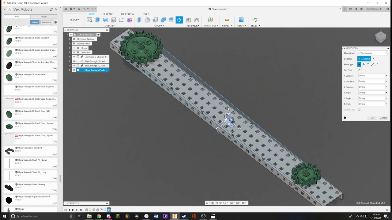

Would you mind also putting in the f3d files? I want to take a look at how you did the chain assemblies.
is there a simple and fast method for CADing chain?
i know a few people have asked but i have not seen a response to that
BTW these CAD models are absolutely terrific vex should link this off of the competition page
Thanks for the kind words, I am planning to live stream me making the 202Z itz robot and you will be able to see how I do them there. But, if you want I can make a video on how to cad chain quickly.
yes please
do you have a YT channel you can link in here?
Here ya go, hope you don’t mind the monotone voice and “um” lol.

Bruh I manually dragged and dropped every single chain link when I was doing my chain lol
This will definitely speed up the process! :smiley:
If you don’t mind my asking, why do you have to subtract .386 from the total distance. Does it have to do with the difference in the chain links forming a polygon rather than a circle around each sprocket? (Meaning the subtracting value would change based on the size of the two sprockets)
.386 is the length of one link of chain (as measured from the center of the connecting hole to the connecting pin). Im not sure exactly where he subtracted that value (as I have not been able to see the video with sound yet) but I imagine he subtracted it when running the length of chain in order to account for the already placed link.

Exactly what @Gameoa said, .386” is the size of one link and to adjust for the 1 link that is already placed you need to subtract that distance from the total distance of the path. The same with the next step, to calculate the total amount of links around the path you divide that total distance by .386”.
