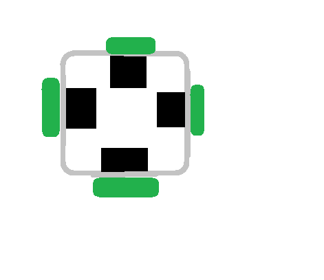

We actually had one of these on our TT towerbot, but we only had 4 omnis. It looked something like this:
Untitled2
Green are omnis, black are motors. The main advantage of a drive like this over an x-drive, however, is that its programming is more consistent, especially for autonomous. Instead of having 4 motors spinning, 2 of them spinning outwards and 2 spinning inwards, it has 2 pushing forwards, so they will get caught less easily.
The main problem with what we had was the front wheels tendency to get caught on a goal. I do not think that this would be a great idea for change up, as with most snailbots, there is an open space in the base for the ball to travel in. It would be hard to include this in a design like that.
like you said, the big problem is that you only use half the motors when moving linearly, which imo is an unacceptable limitation for this type of drive.

The problem was that in order to strafe (without turning the robot at the same time) you had to apply some counter-rotating force/power to the front wheels. But the amount of that power was very sensitive to the weight that the robot was carrying and the exact location of the center of mass.
For games where the amount and location of the game objects inside the robot is variable this makes it extremely annoying to control, because robot keeps turning while strafing and dynamically programming required corrections in software isn’t easy.
