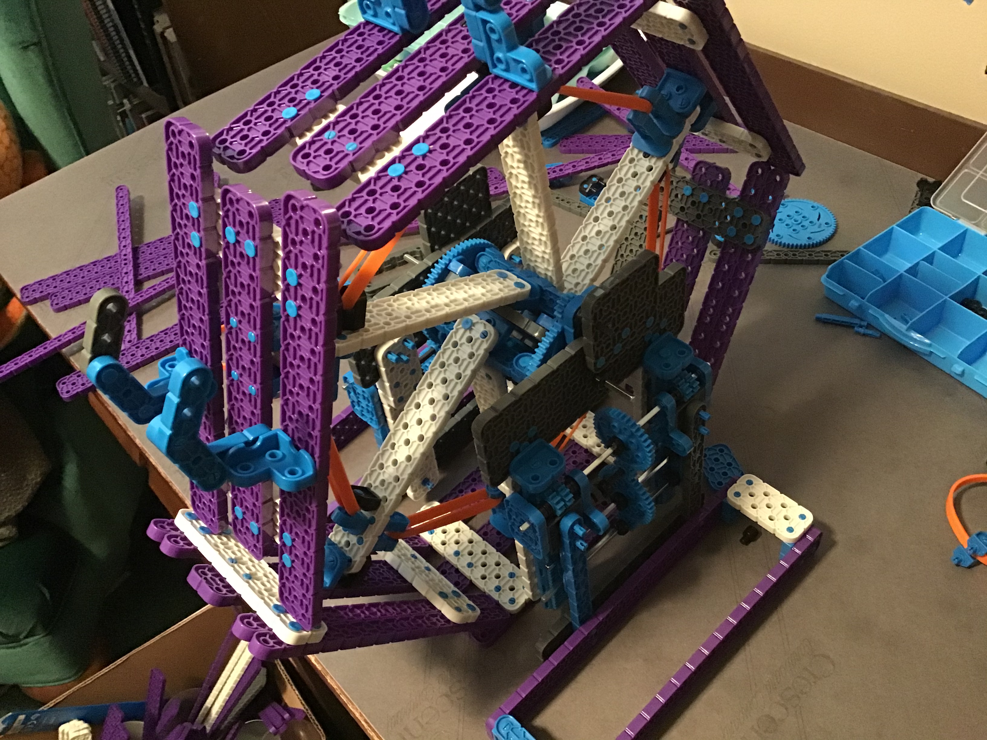

I am doing a Ferris wheel type robot . It can grab 6 risers at a time. Did anybody else think of doing this too?
wow. will you be posting a youtube video about it
I don’t quite know yet. If you want, I can post some pictures of how it is coming so far. I am waiting for my next shipment of parts to arrive.
ooooooooh
How are you gonna do that? Can you tell us the robot idea in a bit more detail?
Really Show me That, I am goona go out of my brain
So the wheel itself is I think 14 and half inches and the claw fills up the rest of the height limit. I made the drivetrain with 2 linear lifts on the sides 4 * 12 plate. That allows me to lift the entire wheel off the ground. Thereby allowing it to: hold all six risers, reach the third riser, and finally stay within the height limit. The center of the wheel is made up of two 64 tooth gears connected in the outer holes by 1 by 6 beams. I then ran 2 by 12 beams off those and attached them to plates with hooks that hold the risers in place. BTW does any body know where to get those spring pieces? Can’t seem to find them on the VEX website. Here are pictures. (Nowhere near done though) If you guys have any ideas that might help could you tell me?

Sorry it said new users may only post one image per post. Here are the rest.
