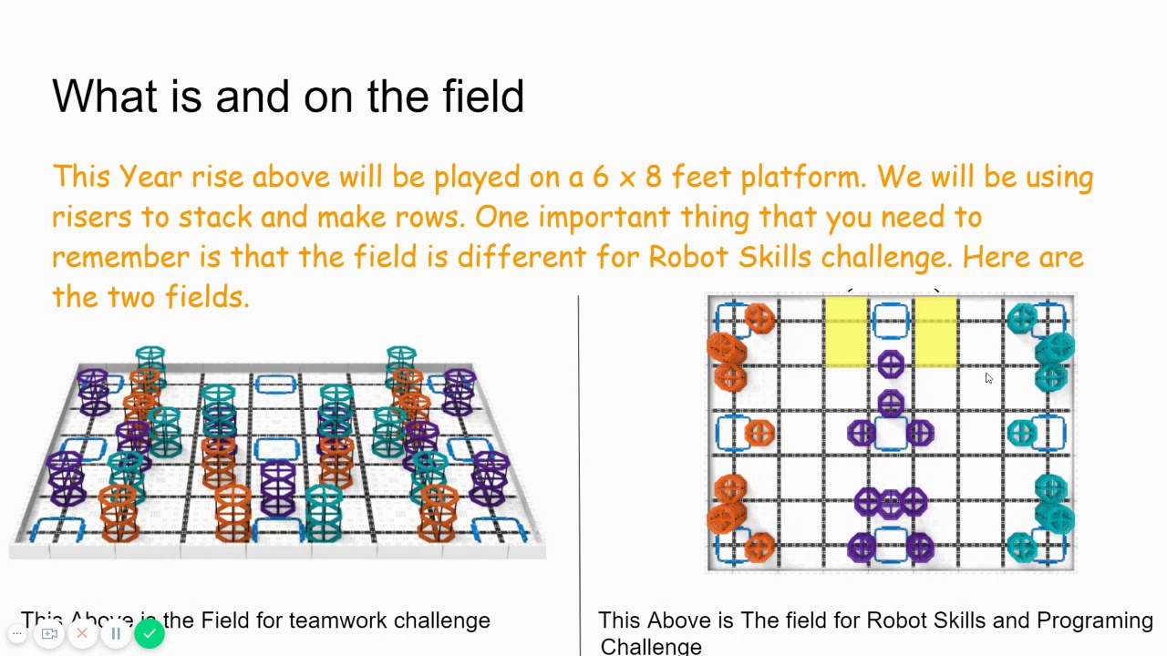

Hi guys I wanna share my strategies for VexIq rise above. Here is mine.
Teamwork
For Teamwork challege our teams main goal is to atleast make 6 three stacks and two rows. So Team A will get all the orenge risers and place it on the right side of the field. Team B will get all of the blue risers and place it on the Left side of the field. Team a will start on the right side of the field and Team B will start on the left side of the field.
Skills
For skills I think you can go for any risers bc the risers are not that spreaded apart.

I am struggling with strategies for the in-person teamwork layout of Rise Above, and I was wondering if anyone had thoughts for new strategies or improvements on what we already have (here is what I’ve got so far). One limitation is that we can’t really grab the blue riser that is on top of the other two consistently.
Thanks!
