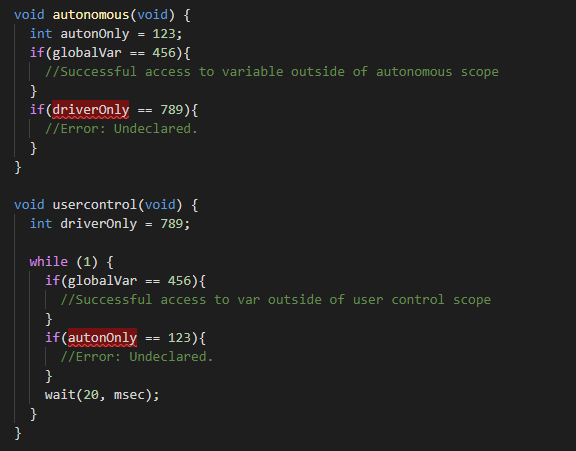

  1. If I declare a variable or a function in the autonomous section, can I use it in the driver control
    period, or is it out of scope? If it is out of scope, then where can I declare it so that it will be in scope globally?

Below is an example of code with variables declared in different scopes.
// A global instance of competition
competition Competition;
//This variable is available to all functions.
int globalVar = 456;
void autonomous(void) {
  int autonOnly = 123;  //only available inside this function.
  if(globalVar == 456){
    //Successful access to variable outside of autonomous scope
  if(driverOnly == 789){
    //Error: Undeclared.
void usercontrol(void) {
  int driverOnly = 789;
  while (1) {
      //Successful access to var outside of user control scope
    if(autonOnly == 123){
    wait(20, msec);
Image of Code Above
You will notice that the editor has a red underscore on the variables with an error. It is warning the programmer that it is Undeclared (or cannot find it).
