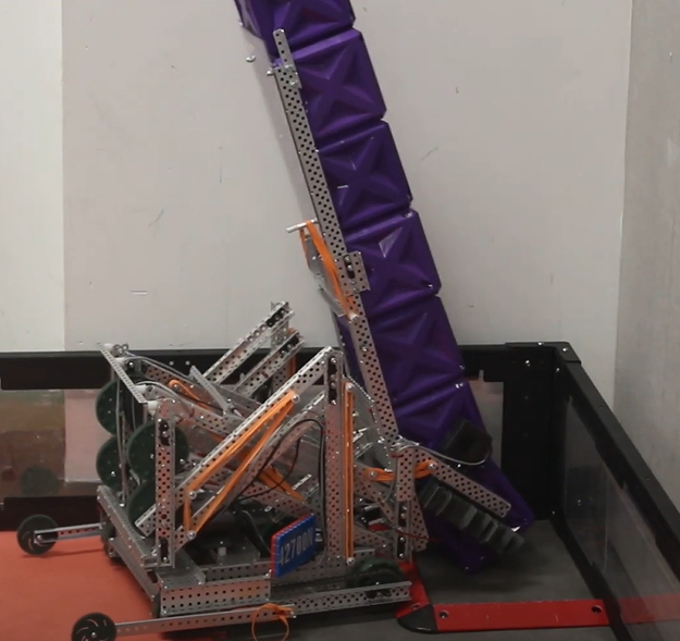

42700N
Robot Specs
  • 3M Drive
  • 2M DR4B
  • 2M Intake
  • 1M Tilter

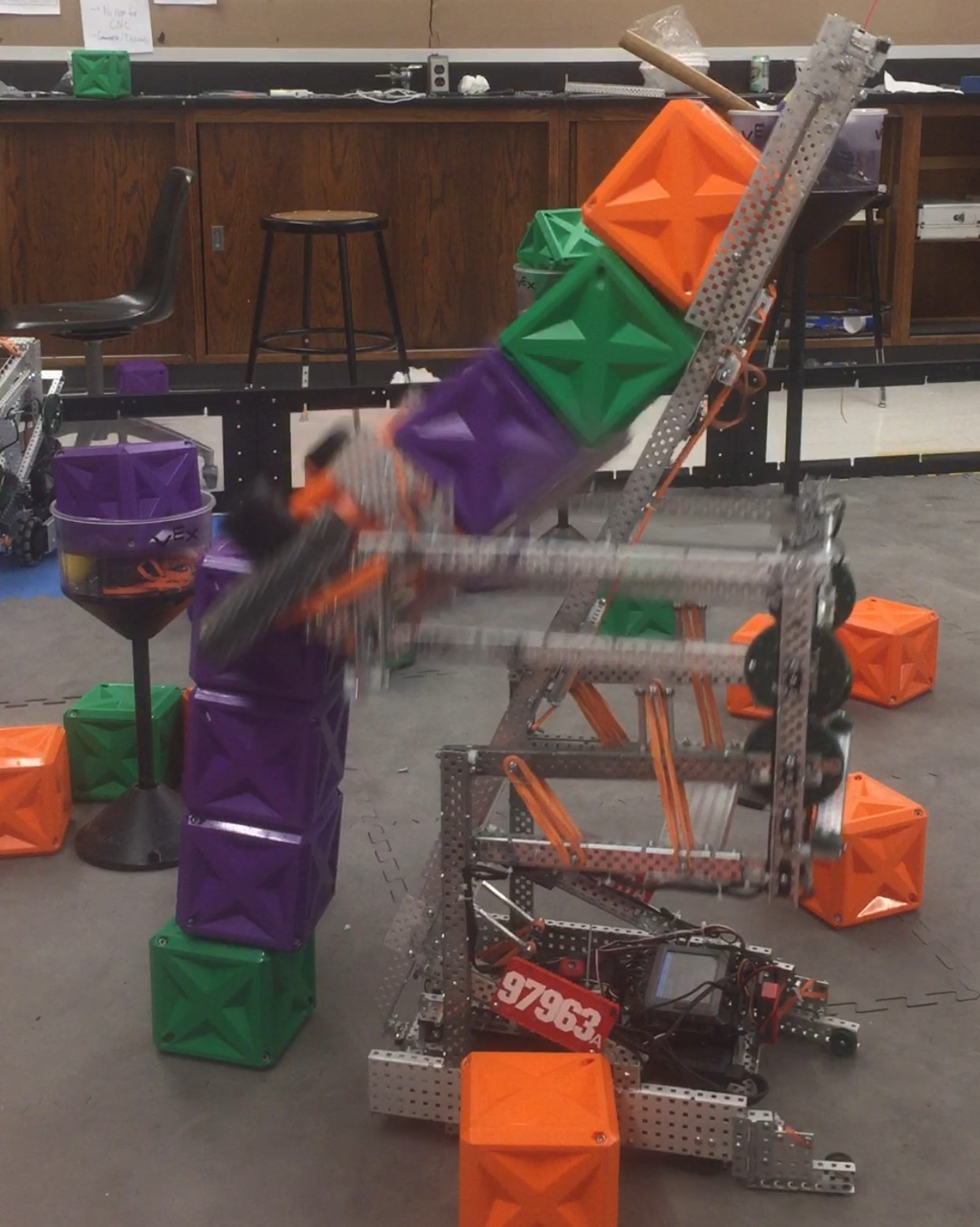

97963A
Robot Specs
  • 4M 200rpm Drive
  • 1M 100rpm DR4B
  • 2M 200rpm Intake
  • 1M Tilter

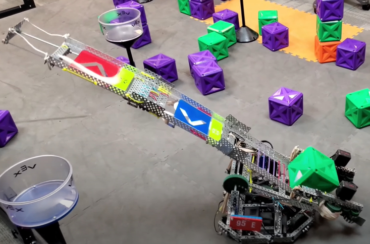

95E
Robot Specs
9 Cube Traybot w/ an x drive
  • 4M 200rpm x drive
  • 2M 100 rpm intake (front sprocket geared 5:3)
  • 1M 100rpm tilter (1:7)
  • 1M 100 rpm lift (1:7)
