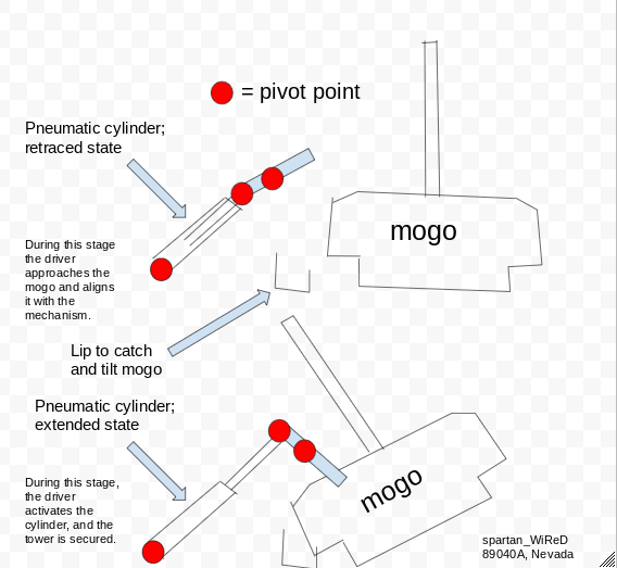

Hey guys, does anyone have an idea of a pneumatic side intake design, we are trying to put 2 pneumatic side grabs at the 2 side of our robot but we literally have no idea about it, any photo or cad would be super helpful for us to learn from, hope we could get some help about it​:muscle::muscle::muscle:

Well are you saying a goal grabber or an intake? You’re saying both. If it’s a goal grabber it’s definitely easier to do than an intake, though I guess you could do a piston powered intake… it’d just be very weird. You may not like it. I can think of one way to do it with intakes maybe, just remember you can use gears.

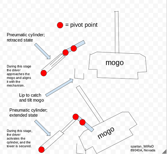

@Elon Hope this helps. Sorry about the quality, I whipped it up pretty fast on google drawings. Make sure to move the solenoid close to the cylinder to preserve your air pressure. If you are using up too much air and the mechanism becomes weak, you cantry using some rubber bands to help it hold.
