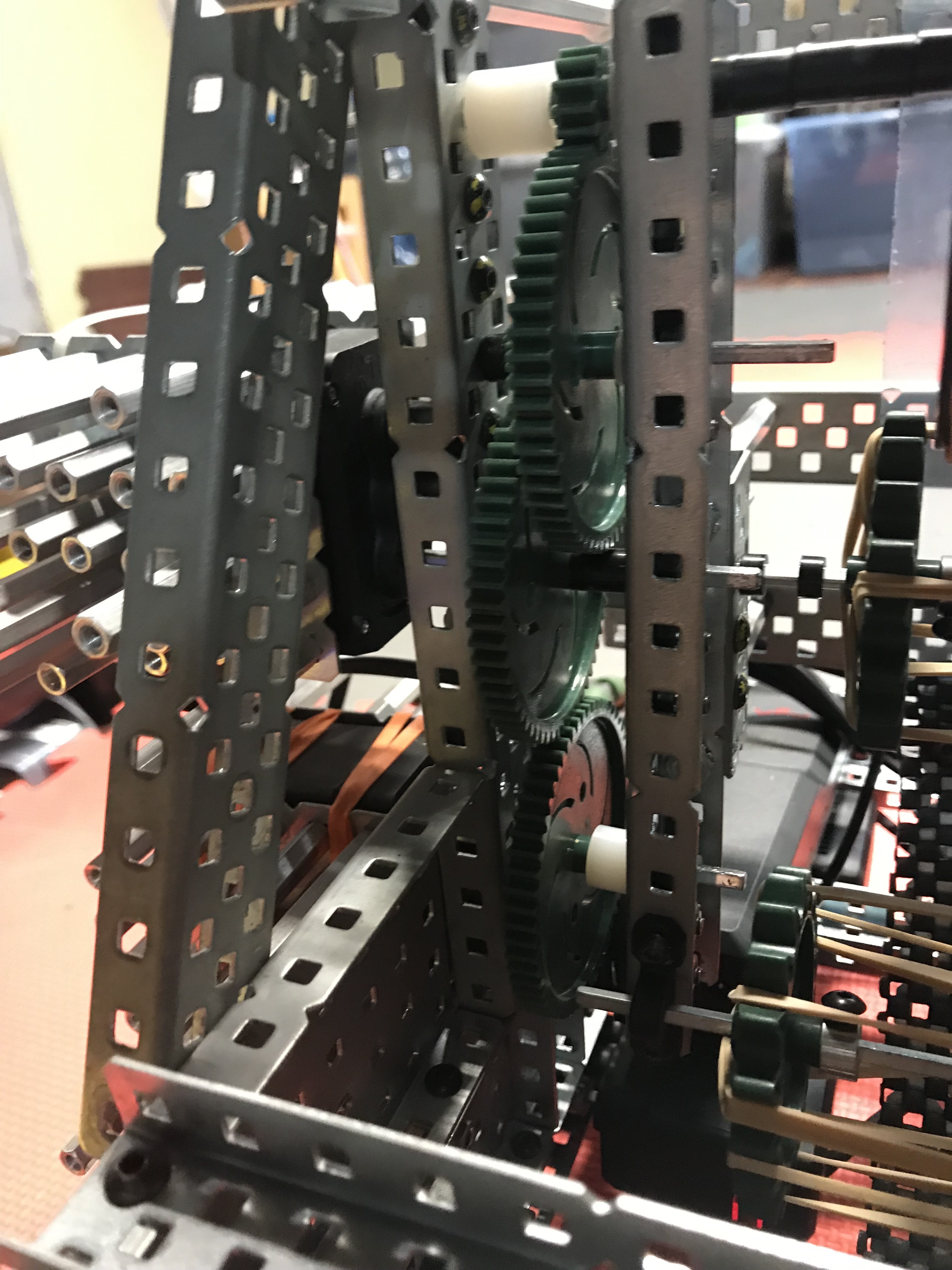

SINGLE flywheel help!
The speed of my team’s flywheel is inconsistent. It runs perfectly for like 10 minutes of testing, then slows down and eventually won’t spin up. I am putting the 2 V5 motors at 87 rpm, 1:25 gear ratio. (we also have a heat sink on one of the motors)
UPDATE: It now overheats about level one after about 30 seconds of running.

How could I decrease the friction? (picture shown below)

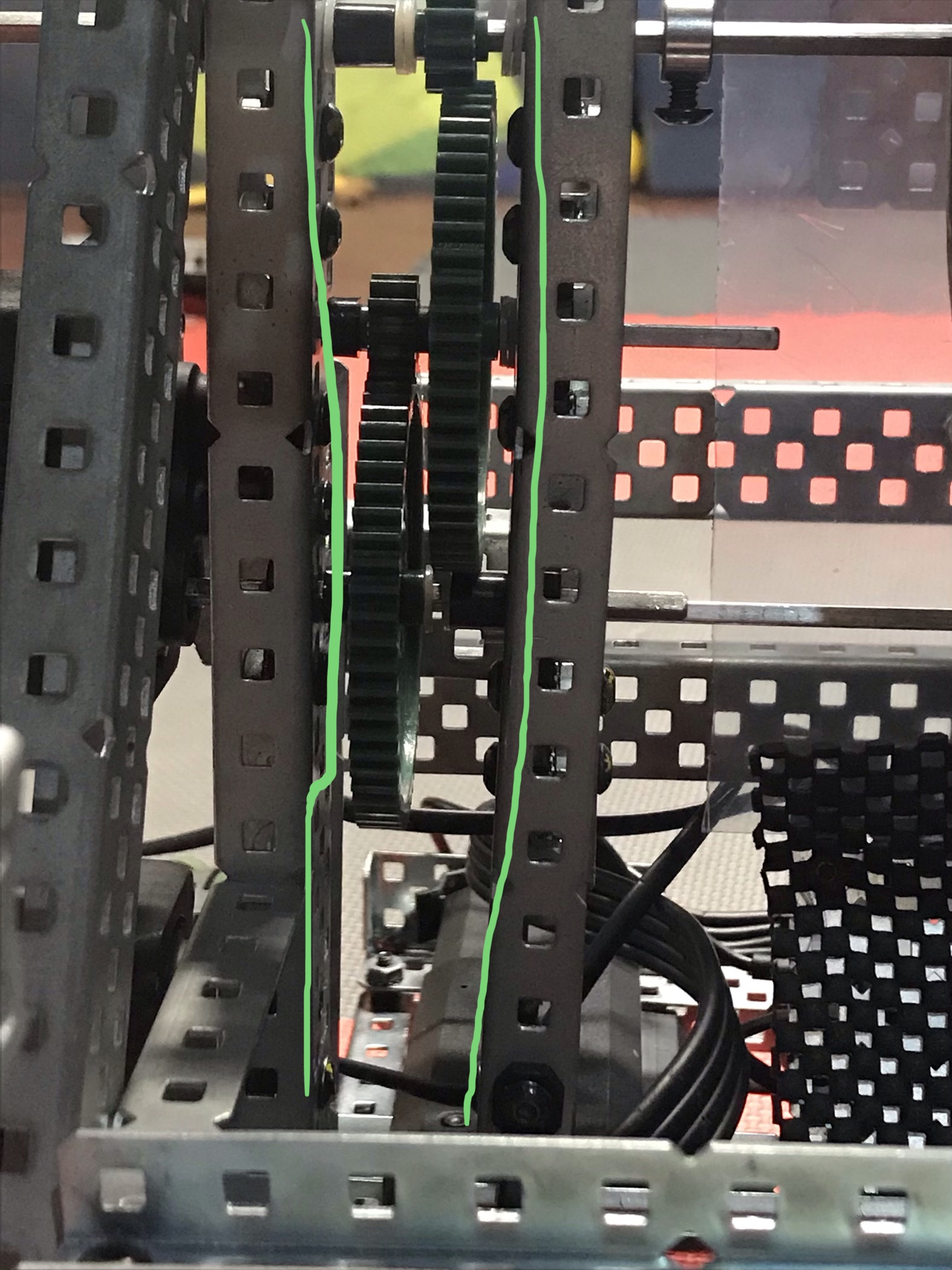

I would also make sure that the structure is square - if the support is non-parallel in any dimensions, it will cause the shafts to rub against bearing flats/blocks more…
Also, only one of the motors is overheating (the bottom one). Should I replace the motor or replace the bearing blocks?
You’ll want to check the bearing block first. If spinning an axle inside of it is smooth already, the motor may be bad. But if the bearing block is rough, you could either drill it (this is the better option, we drill all of our bearing blocks), or replace it.
Looks like you notched the c-channels to connect the vertical structure - is it lined up with the holes correctly?

I see that your flywheel shaft is going through 4 bearings. This is not a good thing, since it is nearly impossible to line up more than two bearings perfectly. Any more than two and you are likely to get massive amounts of friction on the single most important axle of the system. Take off the bearings on the ends so that the gears on the ends of the flywheel axle are cantilevered.

Also, I noticed that one of the c channels is completely bent. Could that be the problem?
