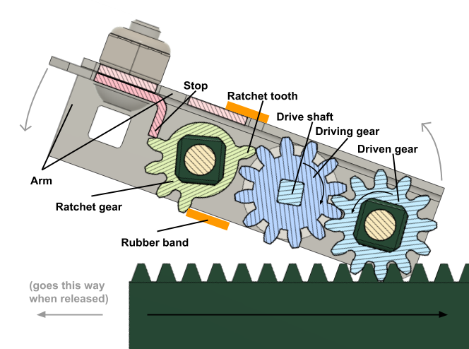

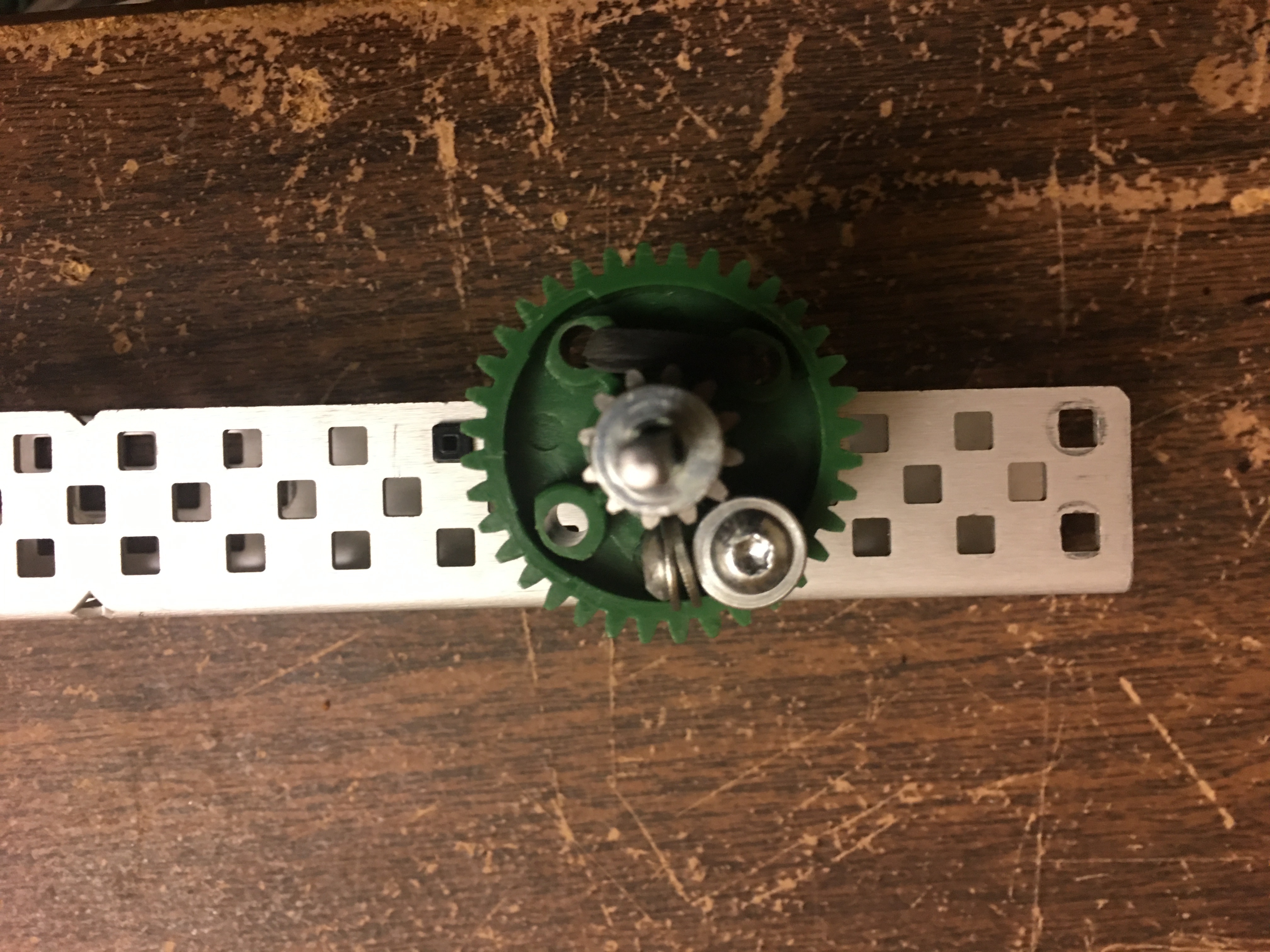

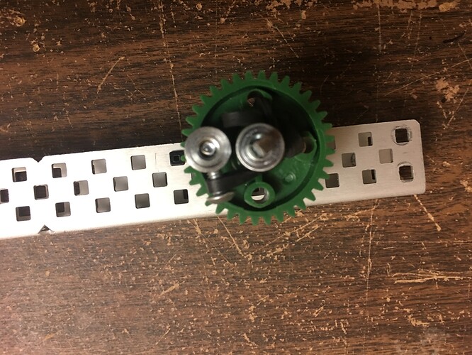

Whats the smallest vex ratchet i can make rn, i dont have parts on me to test and cad isnt the easiest thing to use to see if it’ll work or not
I’m guessing that a 12t pinion with screws as pawl can make a pretty small rstchet
A good resource on this is by antichamber which you can find Here

Uploading: 5E5544E4-8970-4719-80FB-5FECD8E9A35D.jpeg… Uploading: 86C9A8D3-7C03-491E-B2F1-4E0279C8445B.jpeg…
