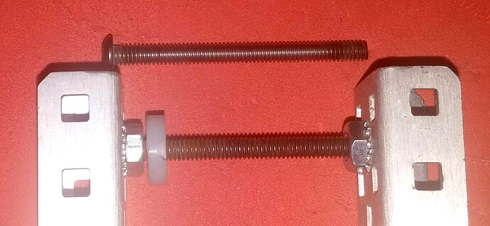

Special partially threaded screw joints and HS gear bearings using modified 393 output gears

The focus of the original DR4B post was to show how long screws in the joints could improve stability and precision of the DR4B lift. I wasn’t going to talk about the other features of that prototype until it could be tested with the real game objects…
Other goals were to see if you can build a stable tall DR4B with minimum number of custom cut parts and easy assembly. I am curious to see if such lift could be stable with just one side and that calls for all joints to be as close to the centerline as possible:
