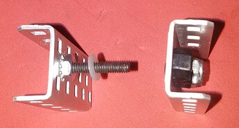

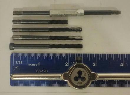

Partially threaded screws
They are available from multiple manufacturers in various sizes: https://www.mscdirect.com/browse/tn/?searchterm=partially+threaded+cap+8-32
To maximize the utilization of the smooth thread-free part you could drill into a flat bearing such that it holds the screw cap.

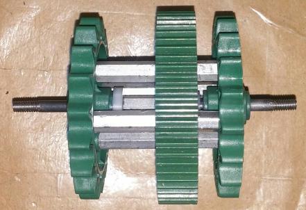

For more advanced use you could modify the screw to have threads on both sides:
partially_threaded_screws_axle
Above is the sequence of steps (from bottom up) taking the 2.5" screw, cutting its cap off, and grinding other end to lock it in the vise. Then threading the smooth side with a #8-32 die, cutting it to legal 2" size and finally combining two of them into a long axle replacement with the aid of the standoff. Using blue threadlocker inside the standoff is highly recommended.
This method was used to build a custom hub. The “axle” both let the sprockets on the green inserts run smoothly and provided additional structural supports connecting chassis on both sides.
partially_threaded_screws_hub

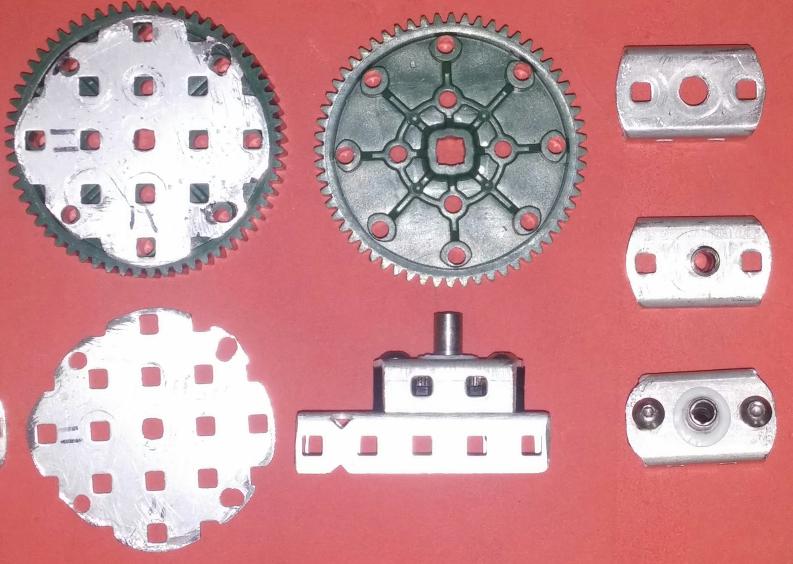

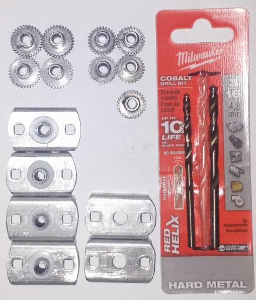

Drilled out 393 gears
Here is a picture of the 30T sprocket on a 393 gear bearing:
393_bearing_custom_sprocket
The sprocket was “drilled” with a standard screwdriver bit and now it fits both 393 gears and normal high strength 1/4" axles and inserts. Just make sure to drill it perfectly perpendicular to the plane of the sprocket.

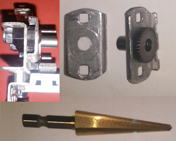

To drill 393 output gears you will need hard metal cobalt bits (4.0 and 4.8 mm) and an access to a drill press. In theory, you can do it with just a titanium bits and a handheld drill, but it will take you 10x longer and you will have to re-sharpen the bits countless number of times.
The best drilling sequence seems to be to, first, drill with 4.8 to the bottom of the square hole, then use 4.0 to drill the gear through and finally use 4.8 to enlarge the hole to its full size.
393_bearing_coupler_mount
There are several ways to attach 393 gears to your structure, but the best seems to be the modified c-channel couplers, which let you mount them almost everywhere. You can use conical sheet metal drill bit to make holes precisely centered and matching gear diameter with a final touches of the round file.
Few more pictures of the parts:

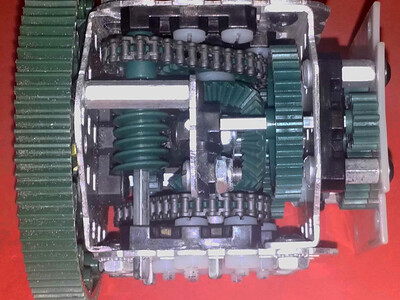

More details of the differential built using drilled out 393 gears can be found here: Differential transmission - power takeoff from the drivetrain motors
Wish I had more hearts to give to this post. Very nice engineering going on there.

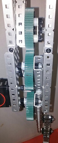

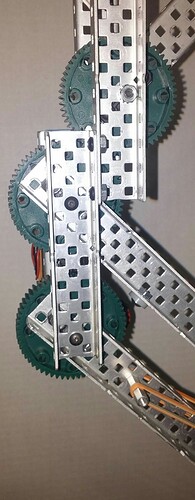

It is a well known “secret” among the veteran VRC teams that it is best to use single bearing screw joints when building 4B, 6B or DR4B/6B lifts.
With them you can achieve minimum slop, which translates into more stable lift that could go higher with more precision and less wobble.
When assembled correctly nylock nut is tightened almost all the way, but not fully such that you could still rotate the white spacer with your fingers.

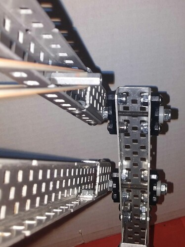

To reduce slop and increase precision further you can use longer (2") screws. Below is a picture of the 2" screw tower connection for DR4B:
However, you have to be careful and need to regularly check those screws, because if they get bent you will end up with more friction losses than benefits.
Similarly, to reduce wobble you could increase the width of the arm/gear assembly in the mid-section. Here,1.5" screws hold an extra bearing on 3/8" nylon spacers (note that spacers are slightly rounded with a grinder wheel to fit the shape of the newer 60T gears):
On the other side of the gear keps nuts are used for better overall stability:
Washers are added under and over the keps nuts to get the perfect distance where c-channel is almost touching the gear.
This fits perfectly with 2" screw that acts both as a gear axle and rigidly connects both sides of the DR4B mid-section. Same as with the tower connection you need to tighten the nuts such that there is no visible slop, but not too tight, to avoid any unnecessary friction. After the final assembly you can use a small ziptie to add some white lithium grease lubricant under the bearings and onto the gears.
As you can see on the side view there is no need for any additional connecting hardware. Four 2" screws used as axles also connect the sides of the mid-section.
You can assemble top and bottom parts of the DR4B separately and then connect them at mid-section to get the optimal alignment between the gears.
