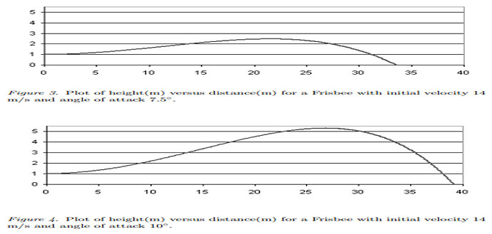

So for comparison to the OP tool, look at the path in the diagrams on page 7, stretched to make Y and X equal:
The path curves upward over the distances that are required for this game. To be honest, the problem of hitting the goal this year is much easier than NbN or TuP, because the target is vertical and the flight path is near flat. The same launch angle and velocity should work over most of the field, since the disc can hit the goal low or high and still score.
You can use same basic trig to figure out the range of angles a shooter would have to be at every distance away from the goal. If you find the angle with the greatest overlap then that would be the most optimal angle. Now, some things to be considered for this.
First, trig assumes perfectly straight flight paths. Second, the MIT diagram assumes an initial velocity of 14m/s. I would think that the discs we will be launching will be much slower. If we are launching them much slower, than the end of the curve may start to have an effect, especially when launching from opposite ends of the field. I think this can be seen in the Purdue Ri2D.

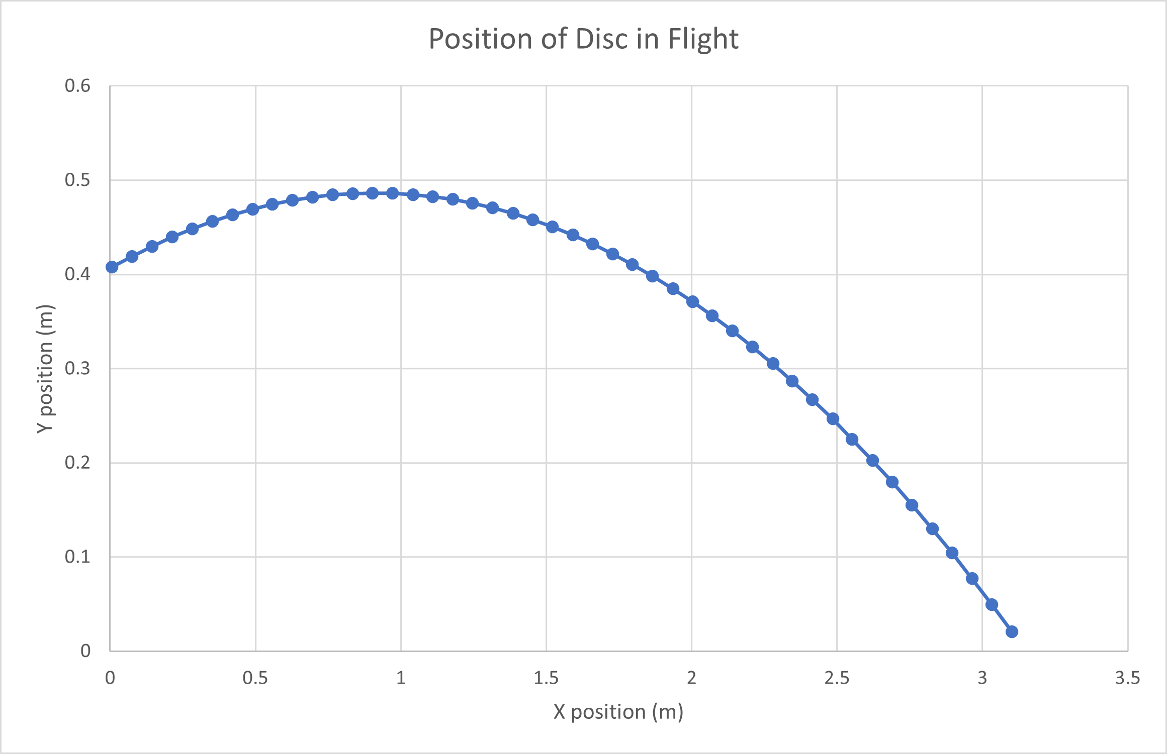

I have modified the code in the MIT paper and ran my own simulations based on it. I want to point out that at lower speeds (about 5 to 7 meters per second), and no angle of attack a parabola does model the flight of the discs that will be used in this years game. Based on my incredibly rough estimations, I took from the Purdue reveal, they appear to be launching the disc at about this speed. Additionally, the purpose of the MIT paper, is to model the changes in angle of attack. Just to clarify, and as stated in the MIT paper:
α is the angle formed between the plane of the frisbee and the relative velocity vector
In other words, it is not the launch angle. The launch angle can be determined by the X velocity vector and the Y velocity vector.

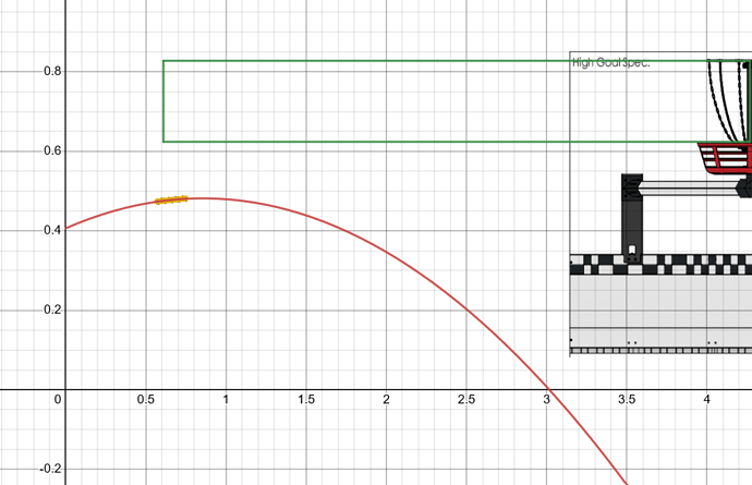

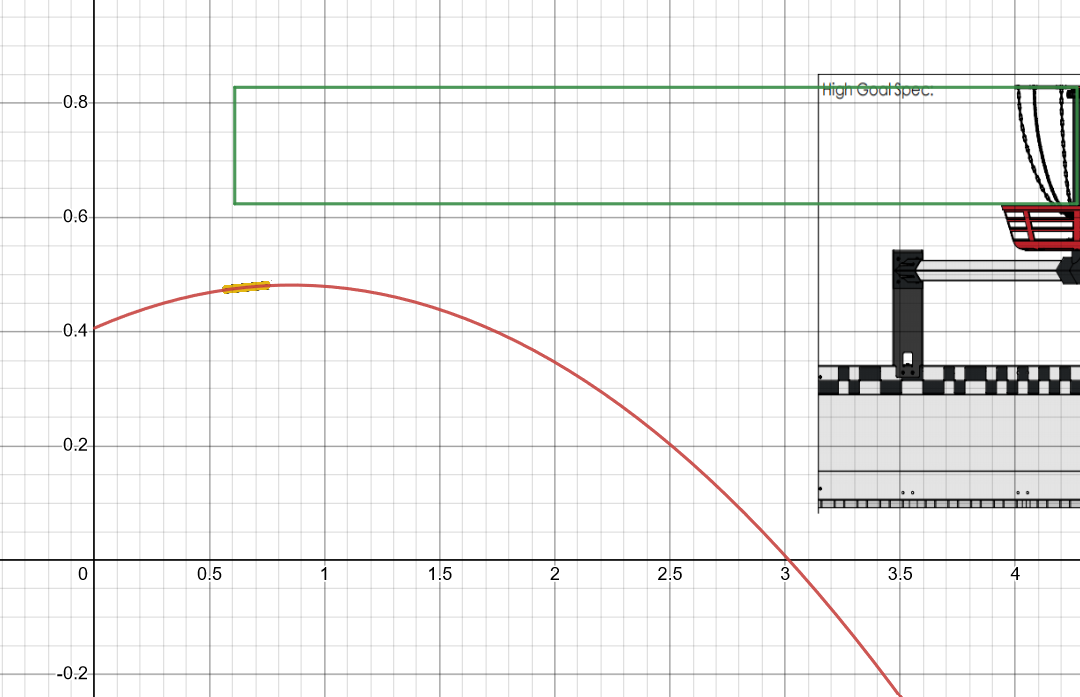

Below is a comparison of the MIT model, which I modified, and the kinematic model posted by the OP:
These are the constraints placed on the disc:
Initial Speed: 7m/s
Launch Angle : 10 degrees
Launch Height: 16 inches from the ground
Angle of Attack: 0 degrees
MIT Model which I modified:
Model posted by the OP
As you can see, with an Angle of Attack of 0 degrees, the two graphs are remarkably similar. This is because the Angle of Attack of the disc is the primary way in which aerodynamic affects would cause additional lift to the disc. Therefore, without this, the disc does behave remarkably similar to a point mass as assumed in the desmos model.
