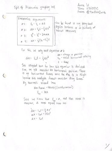

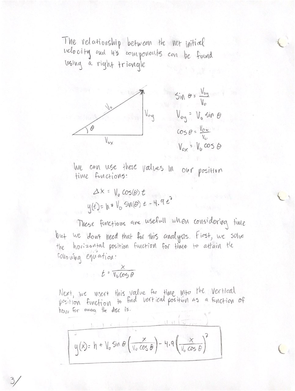

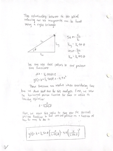

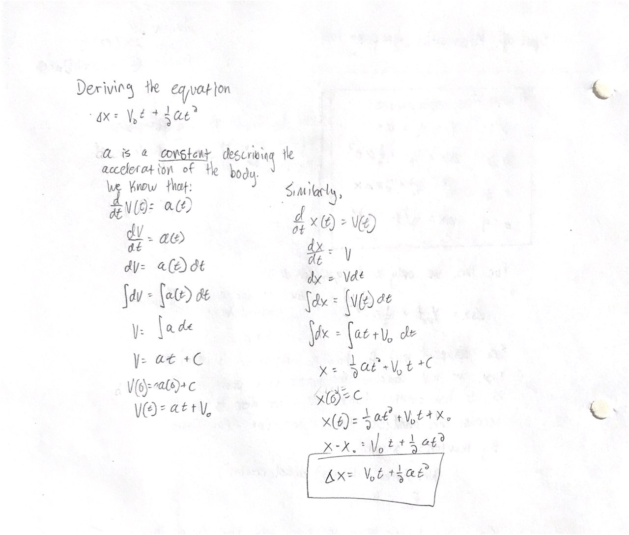

Edit: I amended this post to include the complete math that led to the equations used in the graph as @Sidoti requested. See the below collapsed text below. Also, @DrewWHOOP I am aware of the inaccuracies in this method and the factors it doesn’t account for. I would love to do a more comprehensive analysis of the physics involved. Some other people shared some resources that may assist in that. (I may do so with my physics teacher since my AP exams are over)
Complete Math Here is the math I used to find the equation in the graph. I tried to include as much detail as possible but I may have omitted some details still. As I said above, if you have any questions about it, feel free to DM me or reply below. I did the work on paper because I don't know tools to correctly format the equations digitally.
The kinematics equations used below (I included all of them on the top of page 1) are derived from calculus concepts. (The additional hidden page shows how the equation we used is derived) Except for that, all the math I used was algebra and simple trigonometry and Newton’s Second law.
Page 1/3:

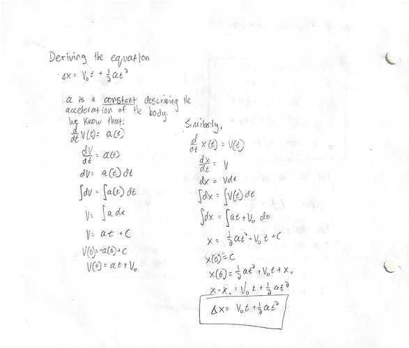

Deriving kinematics equations (Not needed for math)
Page 2/3:
Page 3/3:

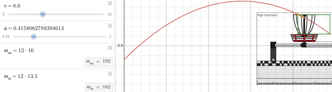

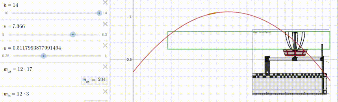

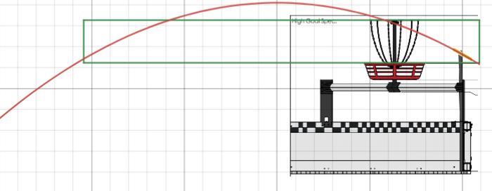

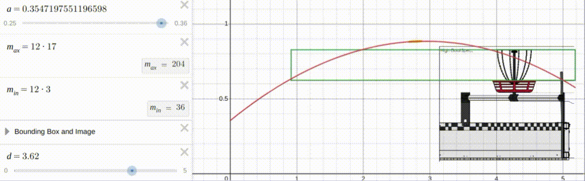

I noticed you can animate the disc and angle at the same time. I set the close point of the green box to three feet and the far point to 17 feet and imagined you could change the flywheel angle. That way you can angle it differently depending how far away you are.
For example, this position would be more suited to where the disc is here:
But this position is better for farther away:
Screen recording 2022-05-12 9.46.38 AM
Changing the flywheel speed is probably easier:
Screen recording 2022-05-12 10.04.21 AM
This way you can change the speed depending on where you are and it will still drop neatly into the base.

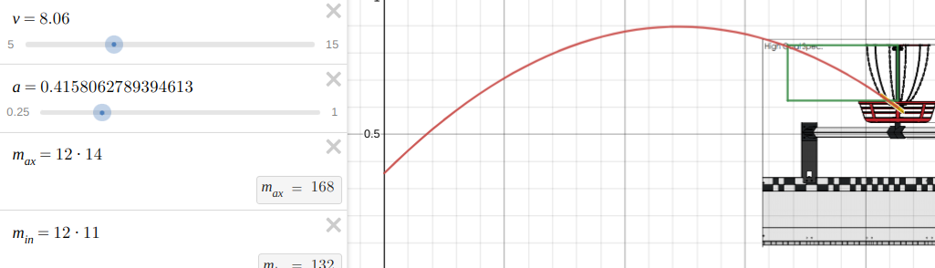

Sure, I can mentally account for any imperfections in the goal that cause the frisbee not to land in it.

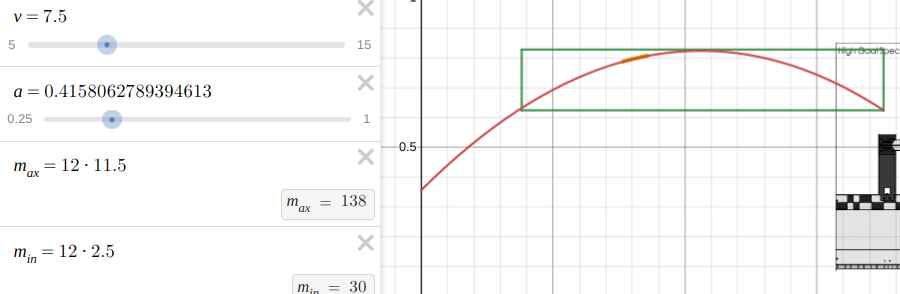

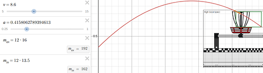

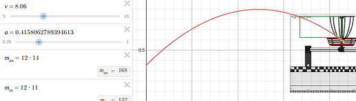

That is also true; you could have a few settings for your flywheel speed that could score from different ranges of positions. For example:
  1. v = 7.5; a = 0.416; max = 11.5; min = 2.5 (blue on diagram)
  2. v = 8.06; a = 0.413 (same as above); max = 14; min = 11 (yellow on diagram)
  3. v = 8.6; a = 0.416; max = 16; min = 13.5 (green on diagram)

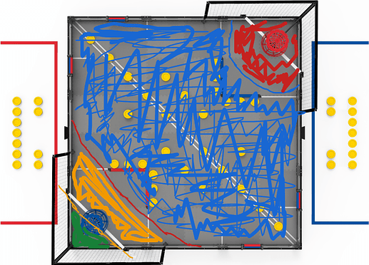

I drew up a diagram of the ranges of these hypothetical arcs, where #1 is shaded blue, #2 is shaded yellow, and #3, which I would not even program, is shaded green. The red part is too close.

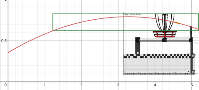

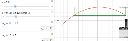

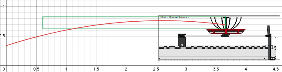

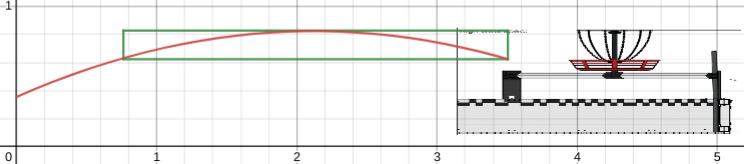

Also keep in mind that the scales were uneven of the axis in the pictures I took. This is a picture that shows the curve with even scales on the X and Y axis.
I have not read through the full PDF yet, but MIT has a nice PDF going over the physics of frisbees. What the others mentioned about a relatively flat flight, then a steep decline is true, and would severely affect the models being shown above.
Here is the PDF: https://web.mit.edu/womens-ult/www/smite/frisbee_physics.pdf

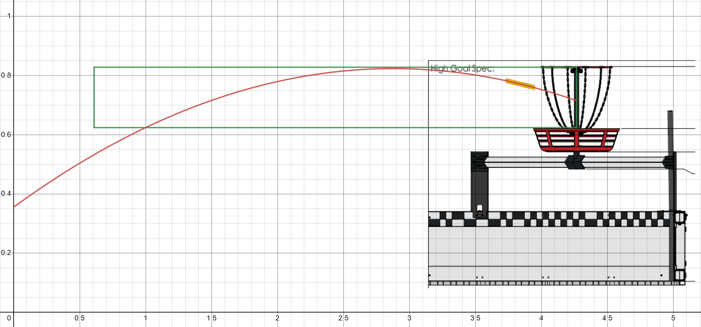

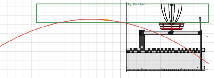

Here is the graph with the same settings as picture #1 but with the scales even:
