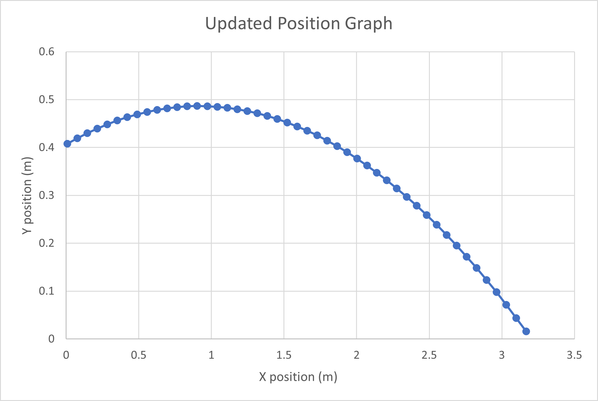

I re-wrote some of the code. This time I re-calculated the lift coefficient and drag with an updated angle of attack. The output I received is very similar to the original.
Original
Updated

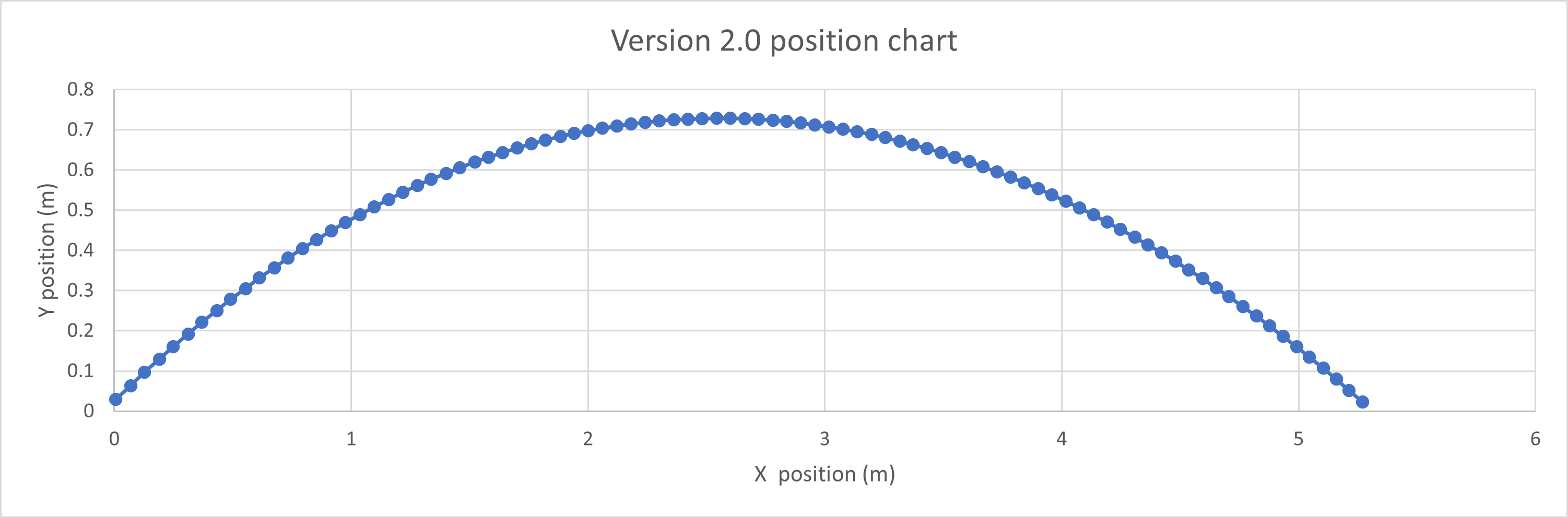

After a lot of messing around and adjusting of values, I realized the discrepancy. I had some bugs in my code, but after looking at it some more I fixed them. I want to say thanks to @46X for his code because it helped a lot. The reason the shape of the graph’s differed was because of a discrepancy in the value for the cross-sectional area of a disc. There was a larger value for this constant in the code on Khan Academy, meaning that the aerodynamic affects were getting multiplied by a greater value than they should have been.
Updated Picture
Also, @46X code works perfectly once this value is changed. I believe the correct value is: 0.0102608 meters squared
Edit
I just wanted to clarify the parameters for the above picture:
  • Initial Velocity: 7 m/s
  • Launch Angle: 30 degrees
  • Initial angle of attack 0
  • Launch Height: 1 in
I’m assuming it’s the lift coefficients being the same for a normal frisbee coupled with the lighter mass of the vex frisbee causing way more lift than is necessary.
When the mass is returned to the original value in the MIT paper, it only moves about 1.5 meters at 8 degrees.
Edit: Thanks to @LastMinuteFix for also noticing that the area of the disc was 5 times higher than what it should have been.
