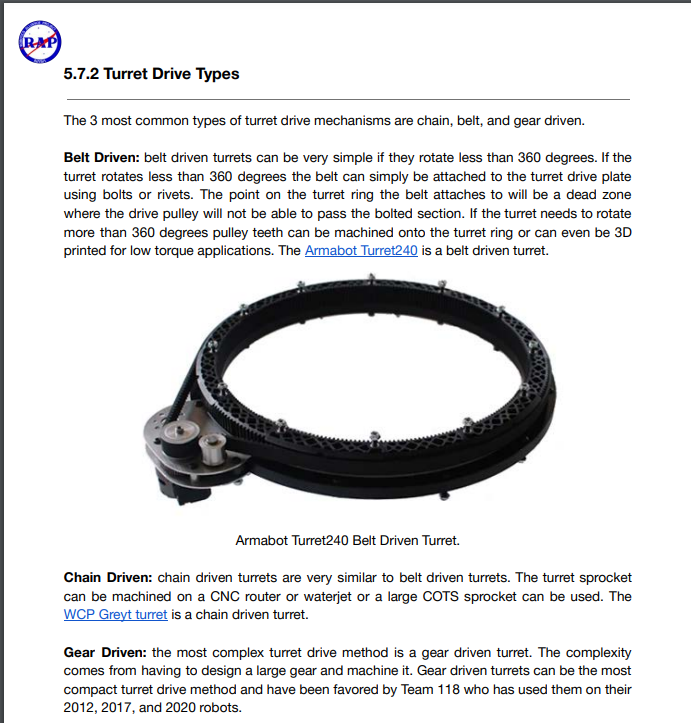

Here’s another possible way to drive a turret, taken from the 118 FRC guide:

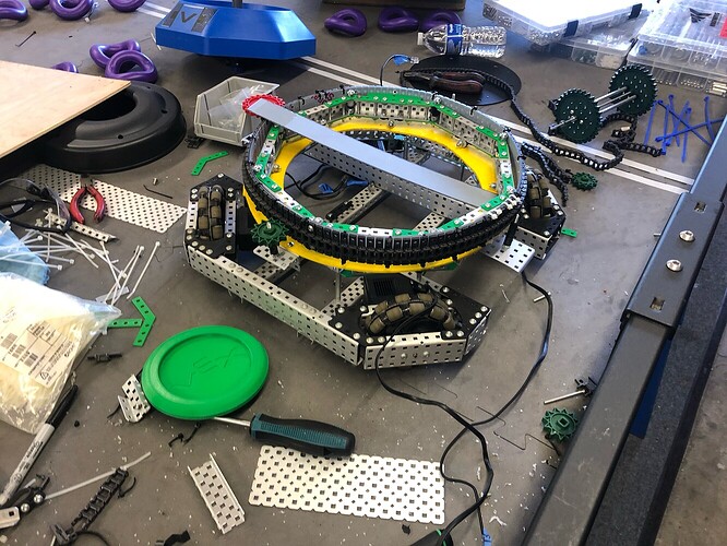

You could use attachment links to attach chain to the turret in a few places, then drive it by spinning the chain. Still doesn’t solve the problem of how to mount it, though.
Also, the easiest way to load a turret would probably just be to spin it back around and load it from a specific place. Not as efficient, but the easiest.
I think the way I saw a turret like this mounted, was either bending flat aluminium, or polycarb around a metal octagon, into a circle, then using the tank treat chain links, the one which you can screw into, with the chain facing outwards, then having sprockets support that chain on at least 4 corners, one of which would be powered to spin the turret.
I think having a set position for a turret to be loaded almost defeats the purpose of the turret, you might as well save the turret motors and have intake into a fixed flywheel. The idea I had for loading into a 360 turret is sort of like an indexer, where the I take would pick up discs and put them into a central column, then a piston would push up the rings into the turret, which then pushes discs into the flywheel.
In the end I’m most likely not going to go with a 360 turret, however if I did, this is how I would probably go about it
Yes, they work great for turrets, it just matters on how you build your turret and how you want your turret to function, etc.

I don’t think that turn tables are the solution. I feel like using them would accomplish the same thing using tank treads
kind of like him (idk who OP is but it’s not mine), and with tank treads you have MUCH more dynamic ability to change the size of the turret to your needs.

First, it uses so much poly. A small turret might be better.
Second, the thing that the turret has to roll on also uses lots of poly.
Code is going along very well. Hopefully, I can have something to show off soon. :smiley:
I think I saw a team just bend the flat alu pieces into a circle instead of using so much poly
Yeah, we’re trying to figure out a way to do it without poly. I was thinking that maybe we could use linear slides, bend then into a circle, and just use that as support. It would reduce friction, and it’s steel so it probably wouldn’t bend… Actually are you having a problem with friction in general? I would like the turret to be as fast as possible so…

I don’t think this will work very well as it will require a lot of precision to bend the slides. You would need to attach the slides somehow. If you get it done well the slides could be really strong, but I think it would still need extra support pieces.
I don’t think that the this method is going to have less friction.
Friction right now isn’t generally the issue with turning, but we haven’t really done many tests. The turret is still not “well made” and is not a high-precision piece.
Florida moment (I’m also from Florida)
UK moment (I was the only uk person to regularly use vexforum in tipping point [only students])
yeah, we were going to have much more support holding up the slides, it would just be that the turret could freely slide cross the thing. I don’t actually know how we could bend it, but I’m sure it’s at least somewhat possible, it’d just be very tedious. Maybe we could just hammer it? Idk. we can try the poly if it’ll be thst much easier. I just really hope it doesn’t get too “problematic”.
